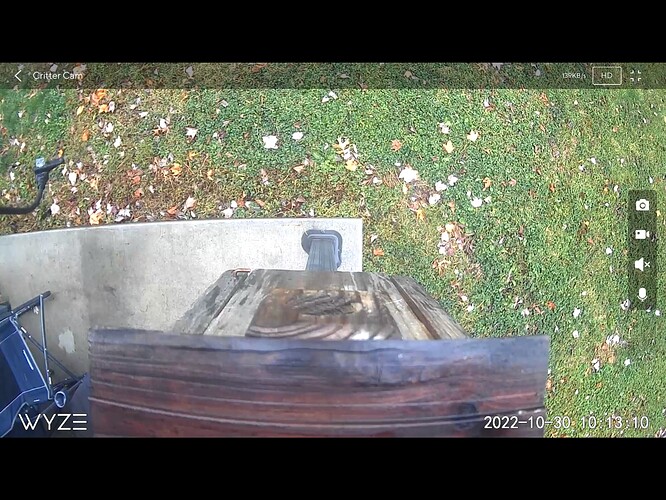

Opened Wyze App in Landscape Mode
Tapped on a V3 Cam live view, it immediately went to Landscape (did not do that under iPadOS 15.7)
Tapped view once, Tapped on ‘back button’ in upper left corner
And BOOM, this toggles between the live view (I see clock increasing by 1 second each second) and a still view of what the camera saw today at 17:20:26
Tapping the ‘full screen toggle’ in the upper right does the same thing.
Rotating to Portrait allows me to exit this loop.

When I open the Wyze app, it starts in Portrait mode like before.
When I select a camera, the view rotates to Landscape mode.
How do I edit the camera settings, view the album, etc. ?
Clicking the left arrow at the top left would normally take me back to the list of Wyze products, but now it just shows a screenshot of a previous event.
Live view that I can’t exit to get back to the list even when the iPad is rotated to portrait mode.
Where do I click to go back? How do I edit the camera name?
As it is now if I want to view a different camera, I have to close the app and reopen it.
This happens with screen rotation locked or unlocked.

Like the title says… Lately as I view a stream in landscape on iPadOS, the “Back” button in the top left doesn’t go back to the camera list. Instead it flips the display to a static display - what I think was last used for the thumbnail display…
To get back to the list, I have to re-orientate the iPad to “portrait”…
