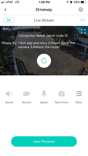

Thanks, I do have that app installed and running, but it only works when I am logged into my own WiFi network. I would like to see live video when I am outside of my network.

@oaktree Thank you for your quick response. I was trying to access the cams with AT&T cellular data and it wasn’t working. The message was Connection failed (error code 0)
After your message I tried it again and Camera 1 (Driveway) worked, but Camera 2 (Garage) did not (Connection Failed). I have the main router a Netgear AC750 in the house and an access point router Netgear WNR 1000 v3. I tried Camera 1 again with cell data and the connection failed.

OK, I unplugged the AP/router for a few minutes and powered back up. This did not change the problem. I did notice something unrelated to the unplugging I think. I got connected to camera 1 using cell data briefly, but it did not seem to be streaming because the time was not changing. Another new thing happened, very quickly something popped up saying something like the network is busy try a lower resolution. Those were not the words, but something like that. I am thinking that maybe my internet speed and bandwidth is not enough to support this feature.

I am confused about the using cellular because that is what I can’t do. When I am connected to WiFi it always works. I just can’t access the cameras using AT&T cellular data. The 0 kb/s was when I was trying to stream with cellular.
I just turned off the AP/router and it still won’t connect but now I have a error code 27.
