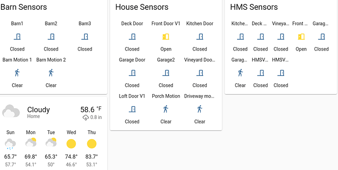

Here is my starter Dashboard:
Very disappointed. Reading a lot of posts on the the github for this sounds like V2 sensors are not currently supported and V1 sensors never will be. Have you found something different? I see in your screenshot motion detection of two sensors…does it actually work? Are your V1s connected to the new hub or the old bridge?
I have my V1 sensors and V2 Sensors connected to the new V2 hub. The dashboard does accurately show when motion is detected on V1 and V2 for me.
The orange color indicates motion on the indoor sensor. I will take another screen shot for the outdoor motion and door sensors.

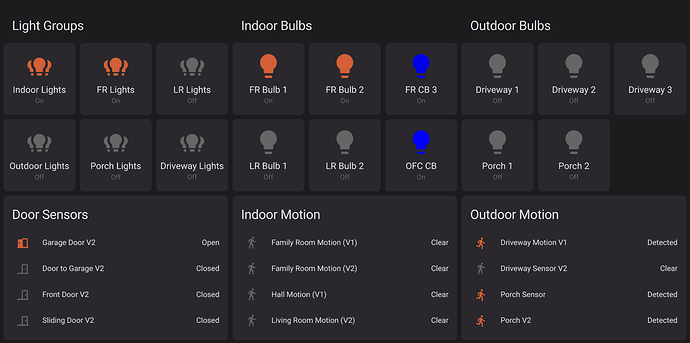

Here is an image of my doors and motion and lights. the blue bulbs are the color the bulbs come on at when garage door is open.
I will setup a rule as well and see if it works for me.
HA isn’t reflecting doors opening. Icons always show closed. Just rebooted the Pi to see if anything changes.
LOL – I let HA pick the card by default. I used the Selection by Entity. There is also a setting to change the color, by default it is off and looks like it is not working.
here is the setting:
Here is Yaml for what I used. I am using a Vertical Stack. Might help.

What I think is cool, but not sure how I did it or it does it, the color bulbs will display as the color you selected. So if I set them to turn Red, the Dashboard Bulb will show red.
After a reboot, icons are updating.
