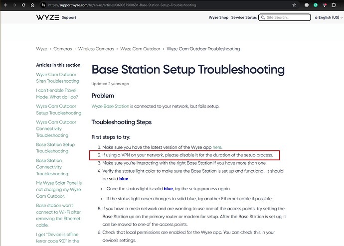

When I was doing so, I swiped down on my notifications and noticed my VPN was on. It didn’t occur to me initially that the VPN service on my phone would cause issues with the set up because I was able to add v2’s while I was connected. However, being connected to a VPN would change my network configuration and cause my phone to be isolated from the network that the base station was on. Which, of course, is mentioned as a possible cause in the troubleshooting steps. I disabled the VPN and the app was able to discover the base station. I’d suggest advising users to disable VPN on their phone when trying to add a base station.
Thank you for your assistance in this, I appreciate that you were able to guide me to a resolution.
Thank you for letting us know the root cause. I am glad that we found the cause, and it will help other users. I’ll work with our support to add this to the support articles.

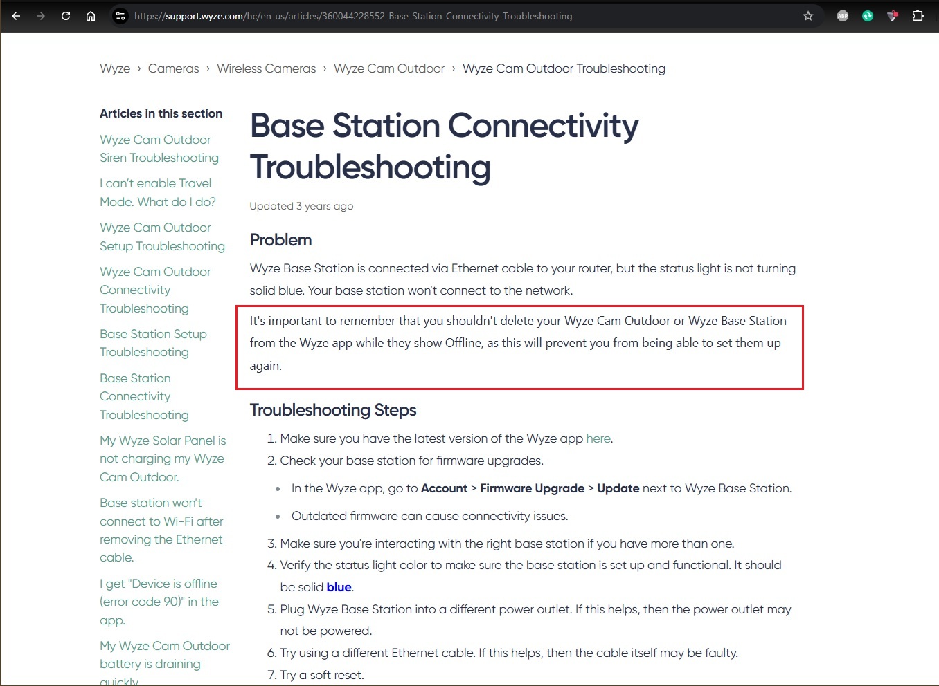

After fighting this issue for a very long time, this is the solution to unable to add base station to Wyze App deleted while offline. Maybe get this into the service instructions
The OP’s solution is already documented:
https://support.wyze.com/hc/en-us/articles/360037908631-Base-Station-Setup-Troubleshooting
Your issue is unrelated to this topic and also documented in numerous online help articles:
https://support.wyze.com/hc/en-us/articles/360044228552-Base-Station-Connectivity-Troubleshooting
