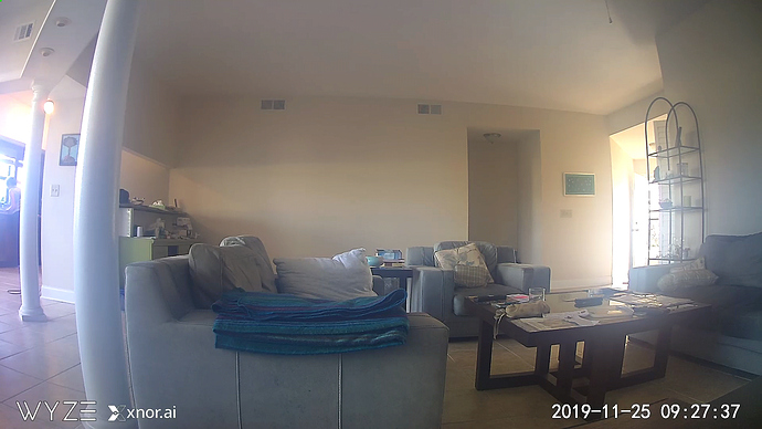

The attached picture is from my Pan Cam. The device is about one year old. Picture used to be crisp and clear, but now there’s a hazy, smokey hue and the image isn’t as clear.
Has anyone else experienced this? Any workarounds. It displays the same way on my android and bluestacks emulator. (I’ve rebooted and cycled night vision several times).

I have had a similar issue. A little lens cleaner spray and a microfiber cloth removed it. Was a light film on the lens. Probably from cooking as no one in the house smokes.
Just tried that. No noticeable difference… but thanks.
Could be this, but you’d have to take your camera apart to find out. If you do, let me know. The fact that your haze developed over time is interesting, and gives weight to my theory that it relates to the oil they seem to be using on the lens threads. (This whole thread may be interesting to you. )

I’d say there’s an 80 % chance that’s the same scuzzy glass problem We’ve found in 5 out of 5 wyze cams disassembled.
I had the same problem with my most recently purchased camera after about three months. It was a build up of some kind on the lense. Took quite a bit of polishing to get it all off.

From what I’ve seen in this thread, it seems like it may be something that develops over time, as opposed to the factory scuzzing it up in the manufacturing process. This one, in particular, seems to follow the outline of the silicone piece underneath it, which seems to indicate that it might be caused by chemical off-gassing of some sort.
There’s also some anecdotal evidence of this, as a few people have reported that their cameras have gotten blurrier over time.
