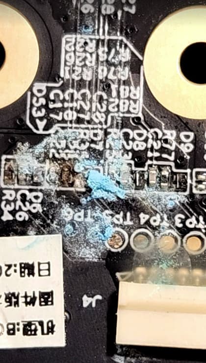

Exactly 367 days to the exact date it last happened; I had another Wyze Lock Bolt keypad completely fail.
The first time it occurred, the fingerprint sensor failed, then eventually the entire keypad itself. Wyze support replaced the entire unit with another refurbished device. Worked great from that point forward for 367 days.
Then… the fingerprint sensor failed. As this had happened in the past, I started chatting with Wyze support for ~45 minutes, resetting things, repairing it with the phone, then deleting it all, etc… only to be told there’s nothing Wyze can do since it falls out of warranty. (sigh)
So I made the painful decision to go a different route and replace the Wyze Lock Bolt with something else.
This is just a FYI for all the other fellow Wyze Lock Bolt users that the keypad can form condensation inside the device during cold weather. Since mine was no longer covered under warranty, I opened it up and took the following photos of the circuit board in the keypad.
Keep yours warm on a cold winter’s night!

I was surprised the condensation was so much that it fell out the USB connector hole at the bottom of the keypad.
While it’s expected that some wear/tear in temperature extremes can cause this, a little silicone, glue, etc… on the board would have prevented it entirely.

opened it up and see corrosion. cleaned it up but still not working.

Well, under the microscope I can see a corroded capacitor that fell off completely. I threw it away. If Wyze did an update to their IPX5 weatherproof to actually avoid this internal corrosion I might try again. I have over 20 Wyze devices and was impressed with the materials used to make the lock, but it wasn’t too weatherproof. For now I bought a cheap one on Amazon and I’ll use it until it dies.
