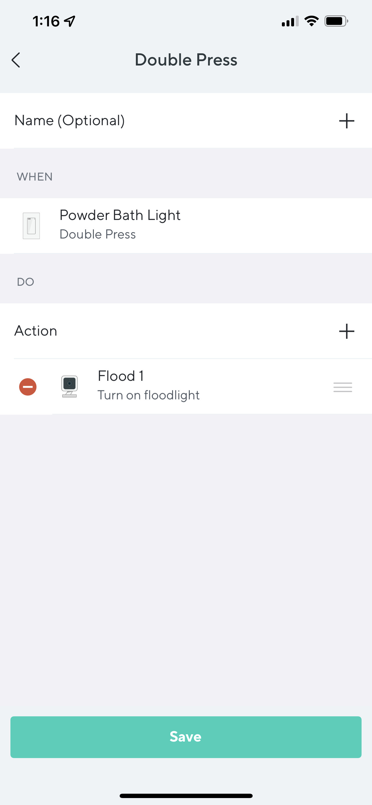

No, Single press will only work as a Classic ON/OFF or Smart Control with the Wyze Bulb. You would essentially be removing all power from the Floodlight.
You could use Double/Triple press on the Switch to turn the Floodlight on and off with Rules. **Keep in mind since you are triggering the Floodlight from a different action the floodlight will not follow the motion or PIR clear trigger to turn the Floodlight off.
Create a Shortcut Rule in the Wyze App to Turn the Floodlight on and Off
