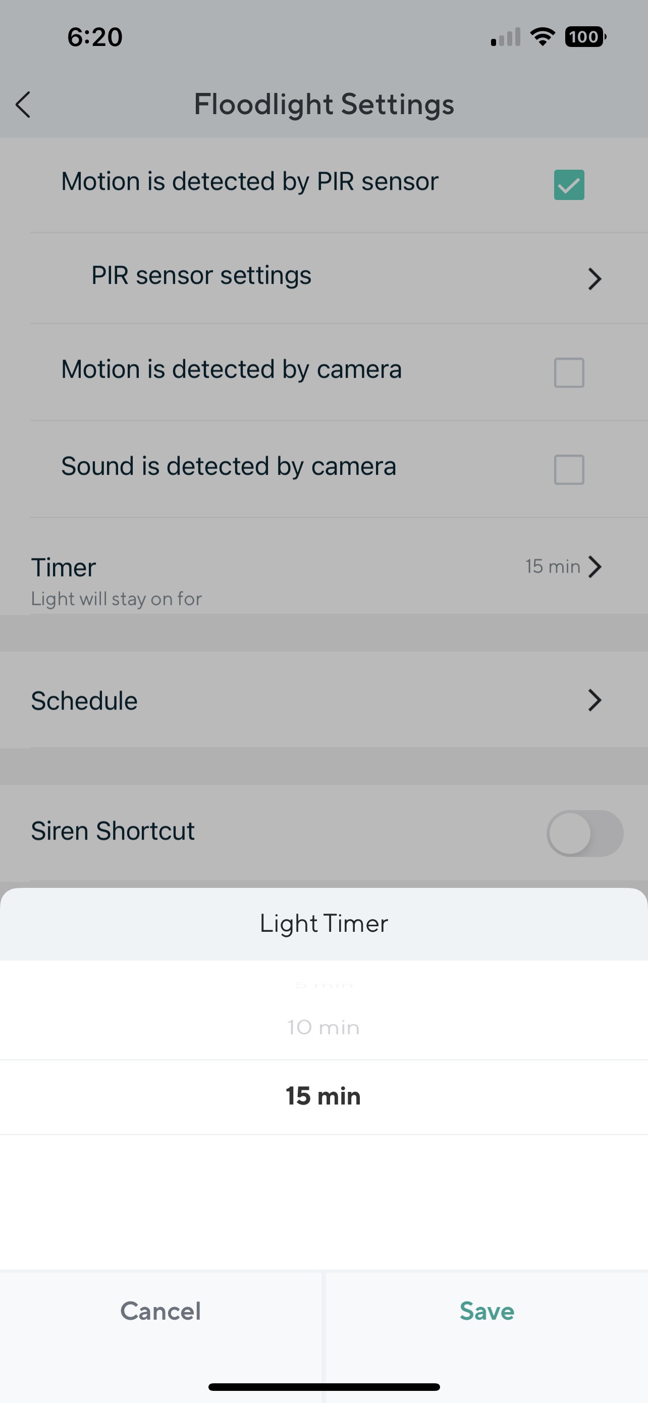

After digging deeper into the settings. If you leave the floodlight motion setting to auto, you can set the timer a max of 15 minutes. That caused it to stay on for the full 15 minutes when toggled on from the icon in live stream screen.
Maybe it will also affect the functionality from the switch.
