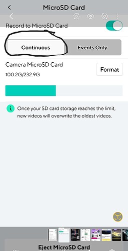

First, do you have motion recording set for on and is it all motion/events, continuous or just events? Second, when you open the sdcard on your phone, are you seeing unbroken continuous green recording bar? Motion on, all motion/events and continuous will capture eveything conceivable but will also use up the sdcard and overwrite more frequently. Unless you are using high and pro endurance cards, expect a shorter life span on the cards.

The second screenshot is for the SD Card. Sorry if I am confusing you. To clarify, it’s ‘on my desktop pc’ that I would like to rewind/search, not on my phone. But if no option without having to remove the SD card then connect it on my pc, I will have to settle for phone rewinding/searching.
So it’s on the phone I am referring to where the SD Card is not recoding all motion/events. I am using a quality 128GB SD Card and no issue with life span for this. So if any setting recommendations for this too, I would appreciate it, thanks.

Thank you very much again for this help too, I have adjusted my settings to match what you have shown me, tomorrow or so I will confirm if it now records the events more accurately. Have a great Sunday!
With the settings adjustment you have given it is now working. Just saw someone walk by then checked one minute later and saw it, that will work for phone rewinding, Deeply appreciate all the help!

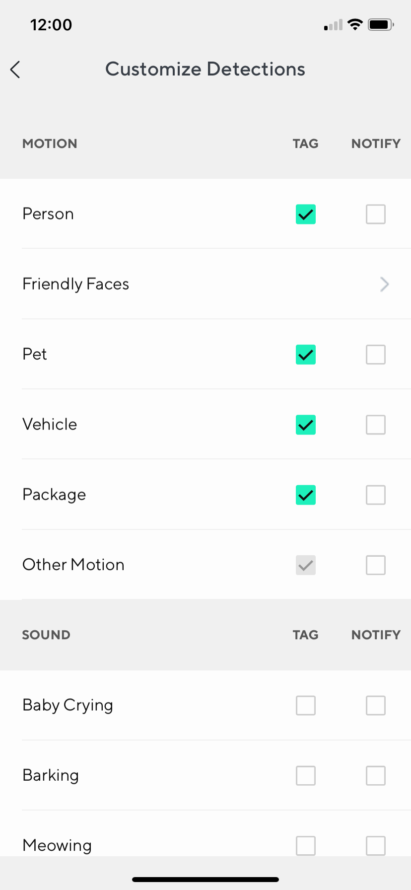

I don’t have Duo Cam Doorbell, but I’ve seen this happen with other Wyze camera and doorbell models, and I’d expect the remediation steps to be similar (at least I hope you have the same kinds of settings screens as something like Video Doorbell v2). Try this:
  1. Navigate to the doorbell’s  Settings ➜ Event Recording.
  2. Under RECORDING PREFERENCES, select All Events and then tap Customize Detections.
  3. On the Customize Detections screen, deselect Other Motion (and possibly Other Sounds) in the NOTIFY column, then tap back to the previous screen.
  4. Back on the Event Recording screen, select Smart Detection Events (and optionally tap to double-check your selections on the Customize Recordings screen).
That may be necessary sometimes because the “Other Motion” and “Other Sounds” lines aren’t available when a user has Smart Detection Events selected, so you have to temporarily select for All Events in order to navigate to and deselect that option. It’s annoying, and some of us in the Forum feel that it’s a bug and have expressed this to Wyze.
information Note that your selection on the Event Recording screen determines what destination is available:
  • If the Event Recording screen has Smart Detection Events selected, then tapping Customize Recordings takes the user to the Customize Recordings screen.
  • If the Event Recording screen has All Events selected, then tapping Customize Detections takes the user to the Customize Detections screen.
I imagine your detection/notification preferences were reset when you set up the doorbell as a new device again.
Yes, I think those instructions works. The garbage truck just went by and I did not get that prompt, thank you very much!
