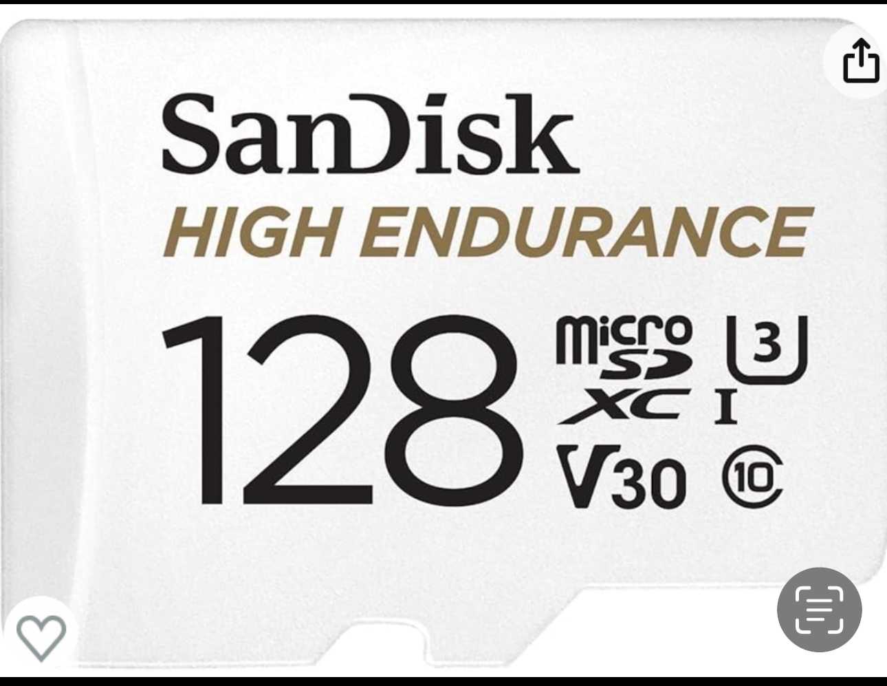

So what card are you guys recommending cause I have this and some from micro center also and still I have to reformat them in the computer

Everyone has their own favorite flavor. I happen to like these and I have never reformatted them is a computer but they are expensive and not for everyone’s needs.

I also use the Samsung Pro Endurance that @Antonius has. However the Sandisk High Endurance are very good too, either one should work fine. The Samsungs go on very good sale from time to time, but right now the Sandisk are pretty cheap on Amazon, 64G for $10 and 128G for $14. I had gotten 128G Samsungs for $13 on Amazon a while back but they’re at $20 right now, so the Sandisk would be the cheaper option.
If you use a site like Amazon or really any online site, make sure you are buying direct from them, not a 3rd party, and when you get it make sure it doesn’t have the white 3rd party label on it.
Samsung has a validation tool to confirm it is genuine, Sandisk probably has one too but I haven’t checked. Then after validating, just do a “quick” format using the SD card formatter from sdcard.org. After that you can use the camera’s internal formatter if you ever need to format it again, this utility just makes sure the file system is 100% correct from the beginning.

I had the same issue on all my Wyze cameras. The SD card had been working fine for a week and then they all had this error. I returned all the SD cards and bought one SanDisk high endurance 265GB micro SD card based on advice in other threads. I’m testing this one card out. So far it has been working. It has only been about a week, so, yet to be determined if the camera will fail to work properly, again. Already have caught video this week of tweaker neighbors breaking in to our community mailbox and talking all our mail, so, I’m glad the camera is working again… for now.
This is the card I am trying: SanDisk 256GB High Endurance microSDXC C10, U3, V30, 4k UHD
