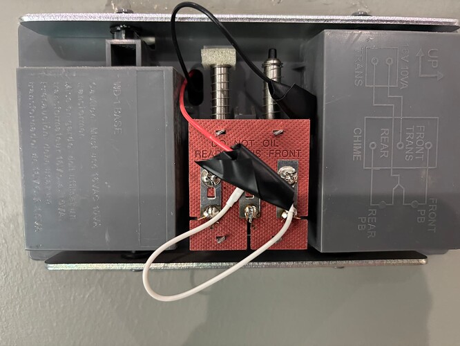

And this is the original chime box. On the left it says must use 16VAC 10VA transformer.
I don’t understand why the red and black wires are taped and don’t know what those are attached to at their other ends. It’s difficult to see even what the installed jumper wire is attached to (looks like TRANS and FRONT) or if anything else is attached to those chime terminals because of the black tape on the red wire and the way it’s obscuring those.
What it looks like in this view is that you’ve completely disrupted the circuit by removing the red and black wires from the chime completely (and then taping the bare wire for insulation) and that your jump wire is connecting two terminals on a chime that isn’t receiving any power at all. (So the jump wire is kind of pointless in this case. It’s not actually doing anything.)
How was the chime wired before? Do you have a “before” picture?
My best guess at this point is that somewhere in your circuit (maybe in the wall behind the chime) you have a red and black wire connected together with a wire nut and that one of the wires coming into the chime box (red or black) was connected to TRANS and the other was connected to FRONT before you started. That would comport with the wiring diagram there on the right side of the image if your previous doorbell was installed correctly and working.

In that picture, it looks like the red wire coming off the right screw terminal is the red wire in your chime box, and it looks like the black wire coming into your chime box is the “return” wire from your doorbell button’s location.
Since I don’t have a Duo Cam Doorbell, I can’t get the app to go through that part of the setup so I can’t see if there was a misunderstanding there, but typically you’d leave whatever wires were connected to the chime’s FRONT and TRANS in place and just add the jump wire across those terminals in order to supply power to the video doorbell and bypass the chime. (If you want the Duo Cam Doorbell to actuate your chime, then the wiring is going to be different and it’s recommended that you connect a Chime Controller to the chime. You could try having Duo Cam Doorbell actuate the home’s built-in mechanical chime without installing Chime Controller, but a lot of users have reported unwanted noises from the chime when doing that, so I think you’ll want to get a Chime Controller if you want the same ding-dong sound you had before you started.)
This is what I’d try in your case for now:
  • Mount the chime box back on the wall.
  • :red_circle: Remove the tape from the red wire and connect that wire to the TRANS terminal, leaving the jumper wire in place.
  • :black_circle: Remove the tape from the black wire and connect that wire to the FRONT terminal, leaving the jumper wire in place.
  • Restore power to the circuit (I hope you had it turned off before) and test.
That should supply power to your Duo Cam Doorbell to charge the battery (my understanding is that this doorbell is powered by the battery even when wired, but wiring to low-voltage AC provides a continuous charge) and bypass the chime so that a button press won’t ring the home’s built-in chime, but hopefully you have a Wi-Fi Chime or something else for hearing button press notifications.
If you want to use your home’s built-in chime, then you can try it without the jumper wire installed (connect the red wire to TRANS and black wire to FRONT but remove the jumper wire from the chime box), but that might not provide the continuous power to the Duo Cam Doorbell and could also result in unwanted noises (buzzes, hums, “phantom” chimes) unless you install a Chime Controller, and adding Chime Controller is something you can always do later if you want to restore the function of your chime box.
