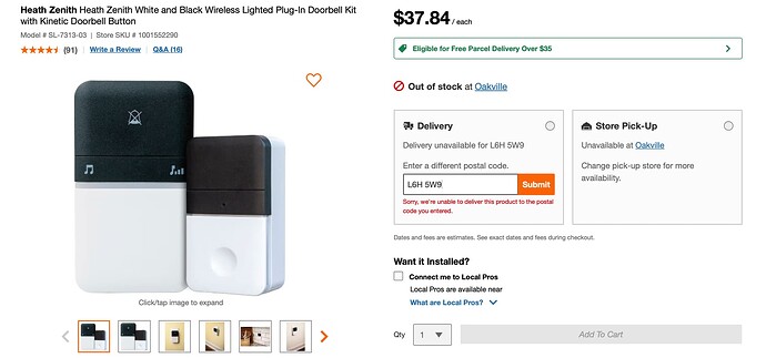

I am in the same boat as you no hardwired doorbell in my house. What I did, I got one of these wireless doorbells from Home Depot, no battery required. You mount the button outside and the receiver gets plugged in on an outlet. I have a v4 camera installed outside that monitors the front door. Whenever someone comes up the stairs I get a notification almost instantly when they press the doorbell. Easy-peasy-lemon-squeesy :slight_smile:
