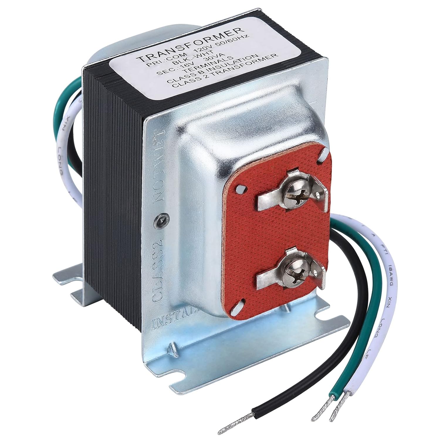

I use the following Transformer without issues with my Doorbell Duo:

I’ve actually been trying to troubleshoot mine, it’ll run for a few days and then lose its connection completely I think my transformer’s going bad. I am going to look into upgrading to this one and see how it goes :slight_smile: originally I bought that transformer for the original doorbell and I think it’s under powered. I don’t remember its specs

Hm, it seems to have disappeared. It was one of the brands with the red face on it, possibly the same brand you have linked there. There’s probably another brand out there, but since the 16v will put out somewhere in the 18-20v range and it has a good strong 30VA current backing it up, as long as your doorbell wire isn’t too long, it should work fine. I’d be concerned with the 24 volt (more like 28+) with shorter doorbell wiring feeding a device that specifies 24 max.

Thank you, Dave. The transformer I tried before this 24V 40VA one is this 16V 30VA one. I read about 18V at the duo cam leads with that transformer. It always says 100%, and shows a battery icon. I have yet to see the plugged in (charging) icon. I’ll try the transformer @spamoni suggested in the first reply, even though it is the same rating as I what I originally had.

In case this helps anyone else, here are the transformers I tried, and the voltage I saw across the leads on the back of the duo cam. I removed the chime, so the cam is directly connected to the transformer.
Defiant 16V 30VA transformer - measured 18V at cam
Maxdot 16V 30VA transformer - measured 20V at cam. This is the same one that works for @spamoni . I’m still using this one.
Newhouse 24V 40VA transformer - measured 27V at cam
