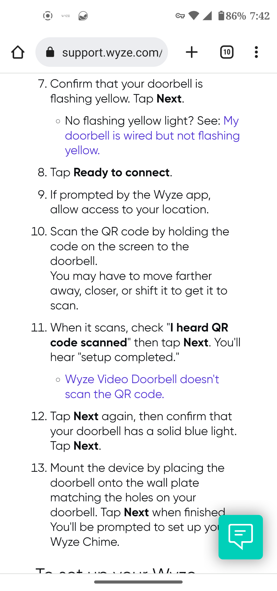

But… In reading the setup script from the Wyze Knowledge Article, there is no mention whatsoever of the doorbell returning a “Ready to Connect” audible prompt. It simply states to tap Ready to Connect in the app when the yellow light flashes and to scan the QR (steps 7-10)
