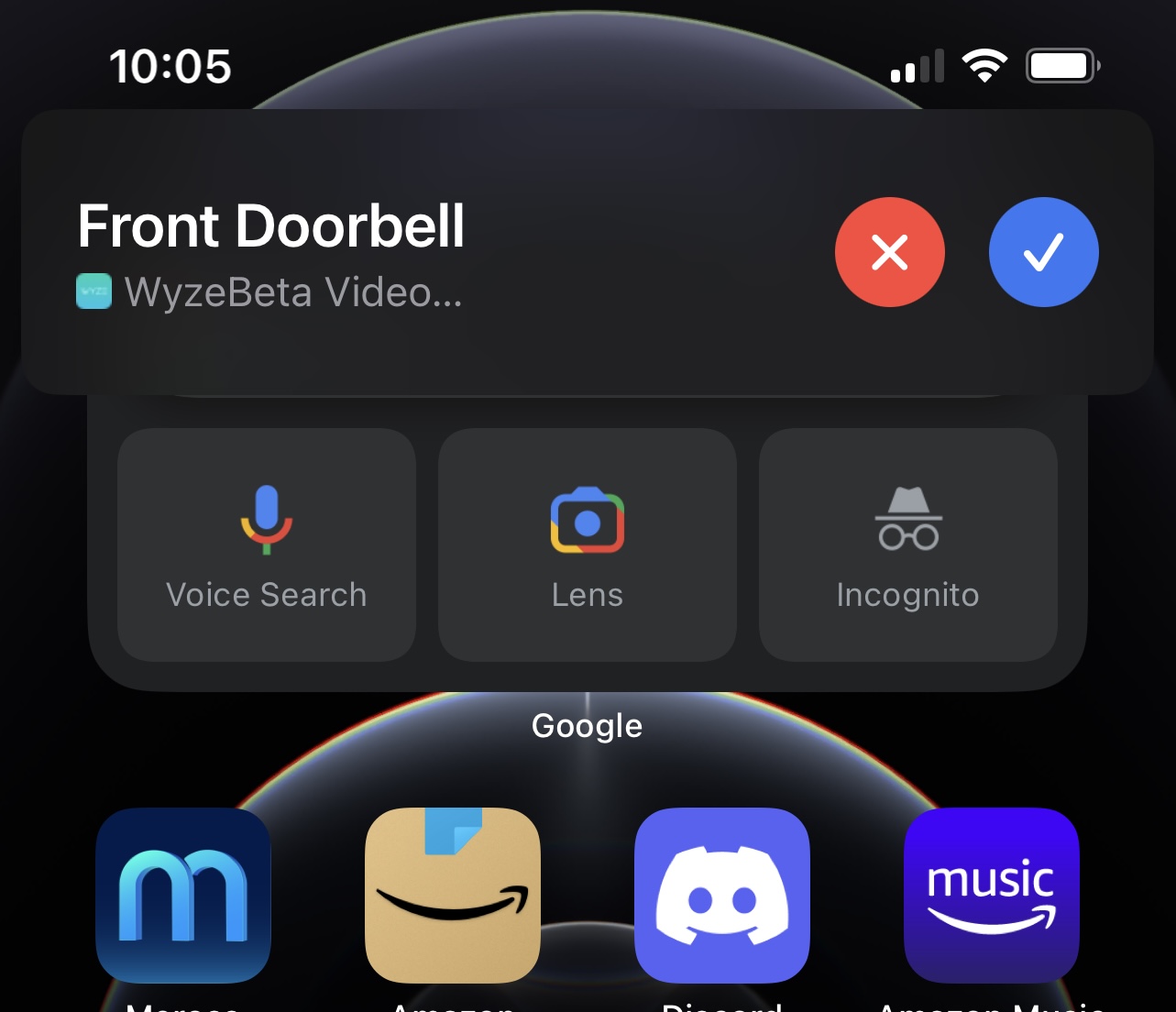

As a test and validation, I removed my Video Doorbell from the App, leaving only the VDBP. Cleared the App Cache, Logged out and Logged back into the Wyze App.
Turned off VOIP and tested and received a notification only.
Then turned VOIP back on and tested. And got the VOIP Call.

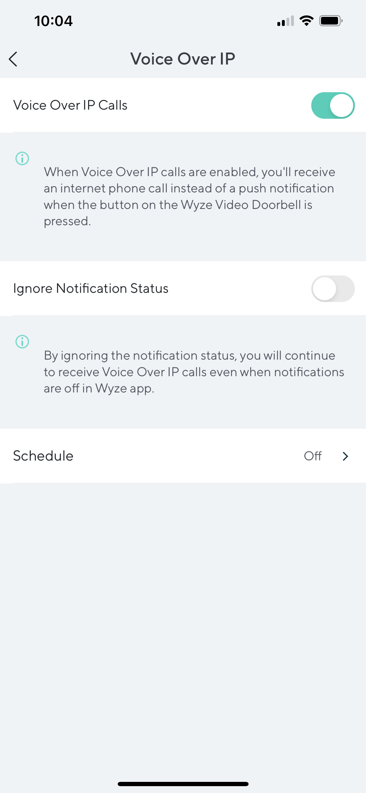

Can you share the notification settings from the Video Doorbell Pro

This is from my Z Fold 4… So could be similar to what you are seeing on the Flip 4
