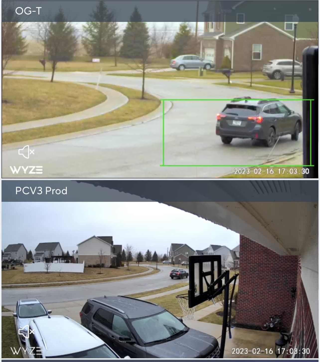

I tried it. Does not work. The V3 Pan vertical motor can’t lift the camera with a OG-Tele mounted to it.

I have a new way of attaching the Wyze Cam OG Telehoto to the Pan Cam V3. By using a piece of aluminum angle extrusion across the arm holding the Pan Cam, I believe I have come up with a way that will minimize the strain on the servo motors. It should be better balanced. I just now got it together and it is untried, but I think this would be the better way to do this. It allows full movement of the camera up and down and should also be less obstructive in tight spots for rotation. I will let you know later when I have finalized the set-up and tried it out how it works. I also got a smaller piece of white plastic extrusion angle that I will try, It is smaller and matches the color of the cameras. So if it works, I will go with that, and it should also look cool.
UPDATE: I tried the smaller plastic angle 1/4” x 1/4” x.05 thick and found it too weak. It had a slight twist between the cameras throwing them out of alignment. I may try another wider and thicker plastic piece, but for now I will try the 1/2” x 1/2” x .062 thick aluminum and cover it with white tape or paint it. For now it is attached with clear double sided tape. Once I am confident with the set-up, I will probably glue it.
