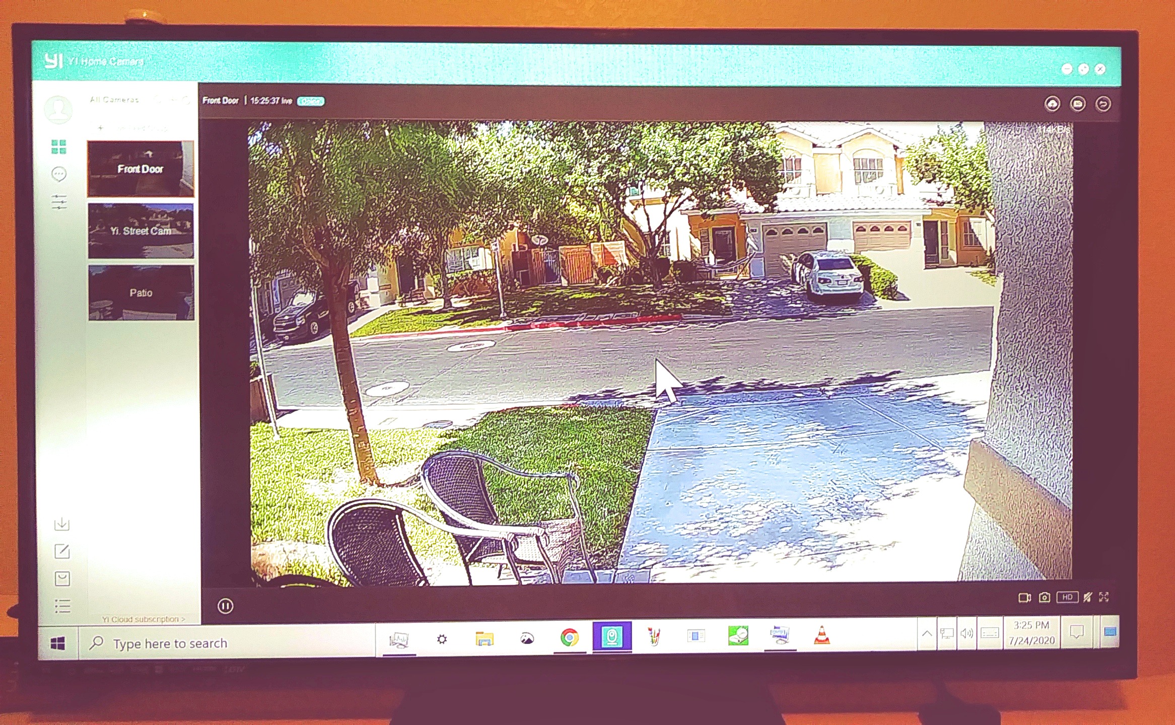

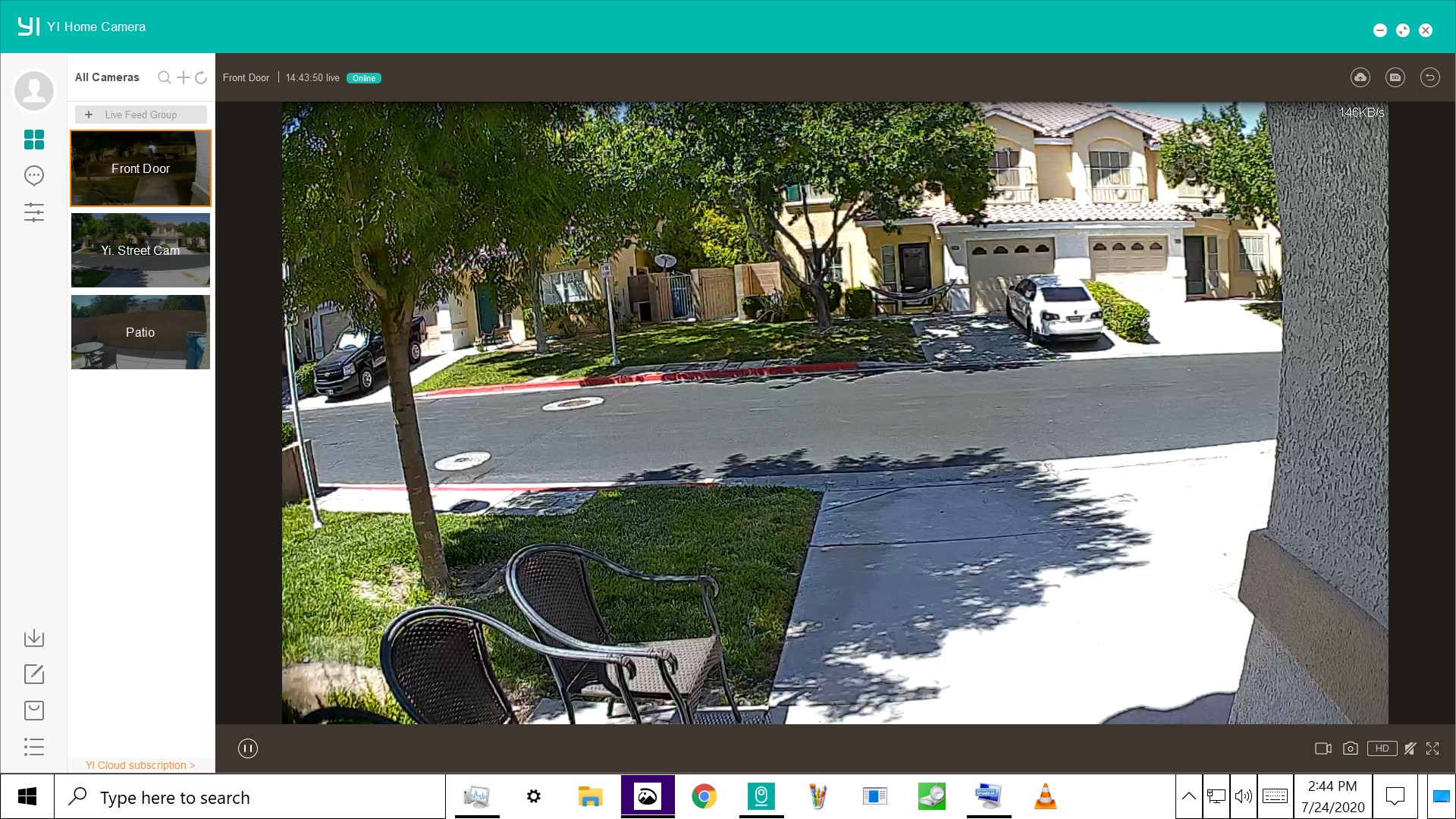

The Yi Home camera app works across iOS and Android plus they have a native free Windows app that you can download.
This how I am viewing my Yi cameras full time (By that I mean it’s always running in the background ready for instant viewing.) on my large screen tv.
I have dedicated an old Windows PC to my tv. I mirror the image to the tv with a 10’ HDMI to a spare HDMI input on the tv. I have found this much more reliable than Wireless “casting”
To watch my Yi Cams I just switch HDMI inputs.
I have a wireless keyboard and mouse on the coffee table. So, not only can I view the cameras, I can use my Windows pc to web surf, etc. on the large screen tv. It’s much faster than my tv’s web app.
I leave the computer on 24/7. It has been working flawlessly for several months.
