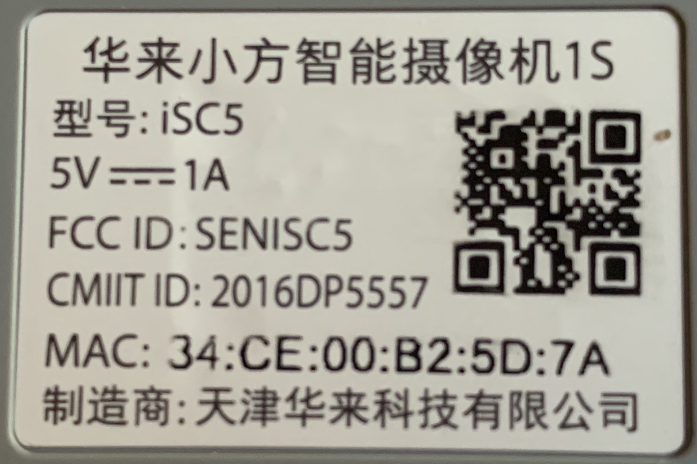

I have three Wyze V2 (I think) cant tell if it is V1 or V2 as everything is in Chinese.
I have reset the camera by holding the button for 20sec.
I go through the process of connecting, I think the camera recognises the QR code, all verbal commands are in Chinese so can’t confirm!! The LED flashes orange/blue.

@AWD… If the label on the camera is Chinese, then it is NOT a Wyze Cam. The bottom of the camera should look like the photo below. This is why you would not be able to set it up. Not sure where you bought it, but it sounds like you got a counterfeit.

i have just worked that out also.
there are a number of sellers on amazon marketing Xiomi ?cameras, identical in all respects as WYZE cameras. You need to get amazon to put an end to it, not good for your reputation unfortunately.

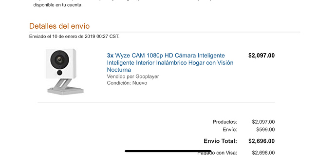

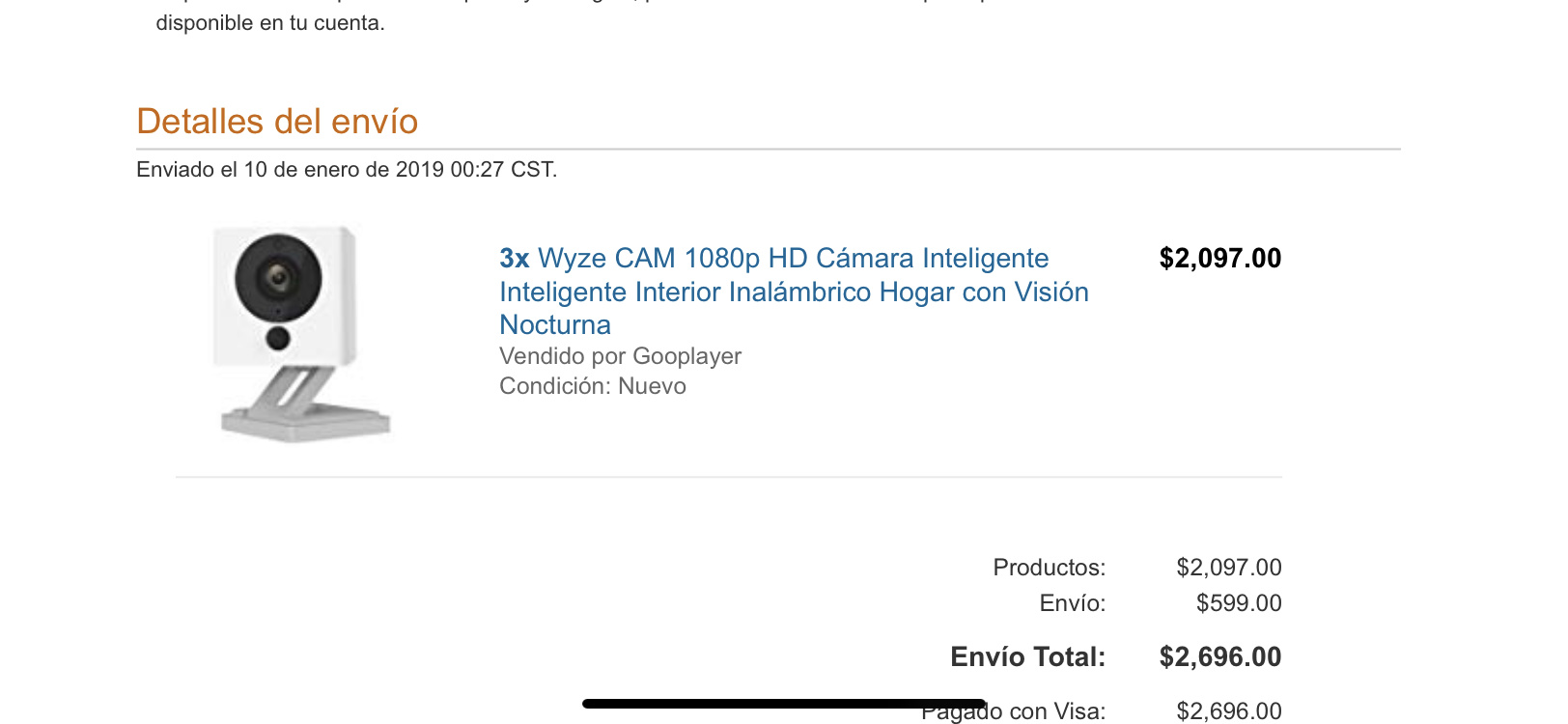

Thanks for the photos. My Spanish isn’t great, but it looks like a third-party seller passing off a Xiaomi camera as Wyze brand. When I search Gooplayer’s store on Amazon.mx now, I don’t find the camera, so perhaps they have pulled it down.
In any case, I’ll pass this along to Wyze. Not sure what can be done about it though. Thanks for calling it to attention.
