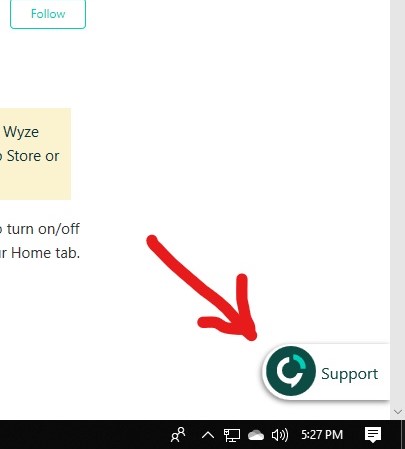

Hi, @chadarmitage. Have you tried contacting Wyze support with “Live Chat”? Click on support and you can speak to a Wyze Wizard about your case.
Screenshot%20(11)_LI
