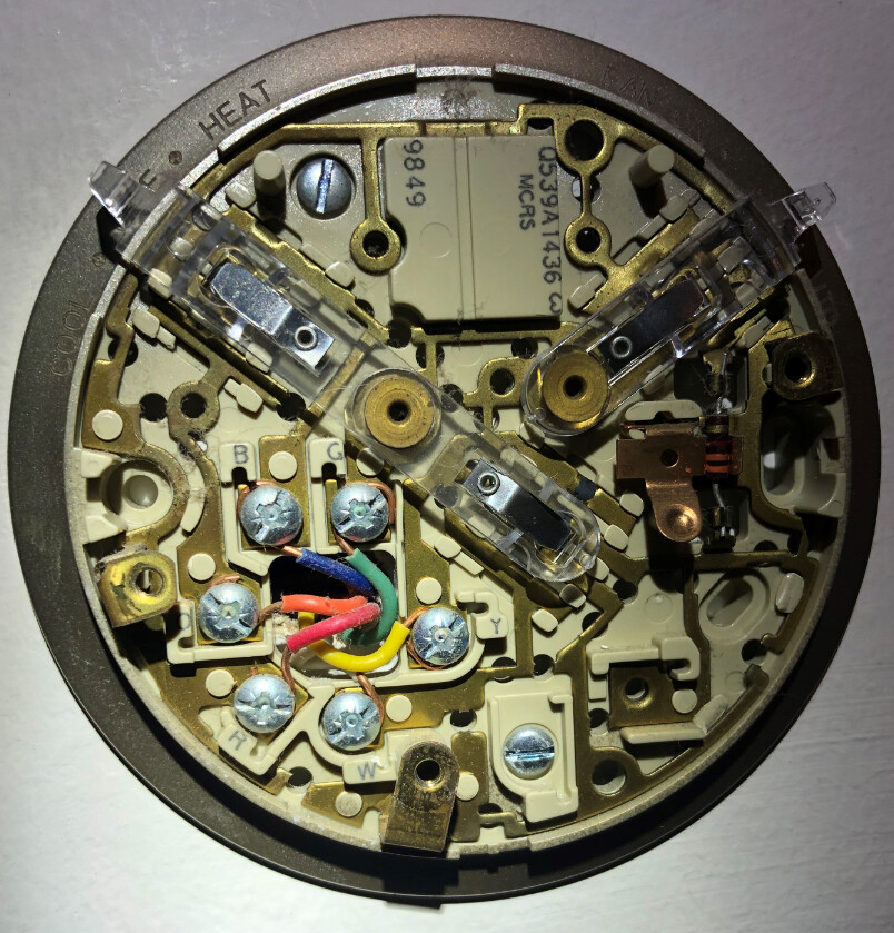

Found this topic might be very close to my question. I have an old Honeywell Q539A thermostat (round mercury type with a switch for cooling, off, or heating). It has 6 wires: W, G, Y, R, O and B. The first four seem easy to do, however, it is hard to know how O and B are connected. According to the manual, O(range) is for cooling damper motor, and B(lue) is for heating damper motor. Can WYZE new thermostat be used to replace my old Honeywell Q539A? I have a transformer in case I don’t have C wire in my current system.
:thinking: interesting… Can you upload a photo of the thermostat backplate and one of inside the indoor unit?
Hi Brian, thank you for your quick response. Here is a picture of my old Q539A thermostat.
Thanks for the image, can you upload one of the indoor unit wiring as well? Need to see how they terminate.
do you mean the other end on the controller? I believe it is a damper controller for I have 2 zones. It is a Honeywell TROLATEMP master control mini-zone panel. See below picture for the wiring. I plan to replace the one for zone 1. zone 2 is off the picture at the right.
