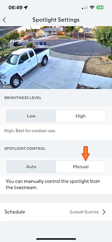

V4 camera. I can’t turn the spot light off. On my “live view” the lower left corner shows the spot light as off. Toggling that on and off does nothing. Restarting the camera does nothing. If I unplug the camera, the split second I plug it back in the camera comes back on.
It is almost as if the internal on off switch is stuck in the on position. Has anyone ever seen this?
Did you try switching between manual and auto back to manual to turn off the spot ?
This V4 is set to manual and the spotlight is off. It has to be in manual to be able to turn it on and off from live view.
Yes. I’ve tried both manual and auto and every combination and no luck.
The high/low toggle does work, but just no luck turning it off.
