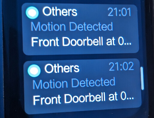

Here’s an odd twist: The duplicate notifications are not always exactly the same. For the Cam Pan v3 and the Video Doorbell v2, the first notification in the pair doesn’t have a period at the end, but the second notification does, e.g.,
:speech_balloon: Others
Motion Detected
Front Doorbell at 01:53 PM
and
Motion Detected
Front Doorbell at 01:53 PM.
or (another example pair)
Motion Detected
Cam Pan Black at 01:58 PM
and
Motion Detected
Cam Pan Black at 01:58 PM.

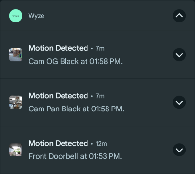

In my limited testing, both notifications from the Cam OG have a period at the end (both on the phone and on the watch). The Wyze app generates only a single notification for each event on the phone, and that has a period at the end:
WyzeCameraNotifications
Why do the different cameras (OG vs. Pan v3, for instance) generate different notifications on the Watch (with or without a period)? Who else has experienced this, and what are the steps toward resolution? If I don’t find an answer here, then I’ll plan to submit this for next month’s fix-it-friday.

Another note: When I received a pair of notifications this evening after stepping out the front door and triggering the doorbell’s motion detection, they came back-to-back as usual but the time stamps were off by 1 minute. I presume this happened exactly as the minute was changing, and it indicates to me that there are two different points in the notification generation process where these are being sent to the Watch.
