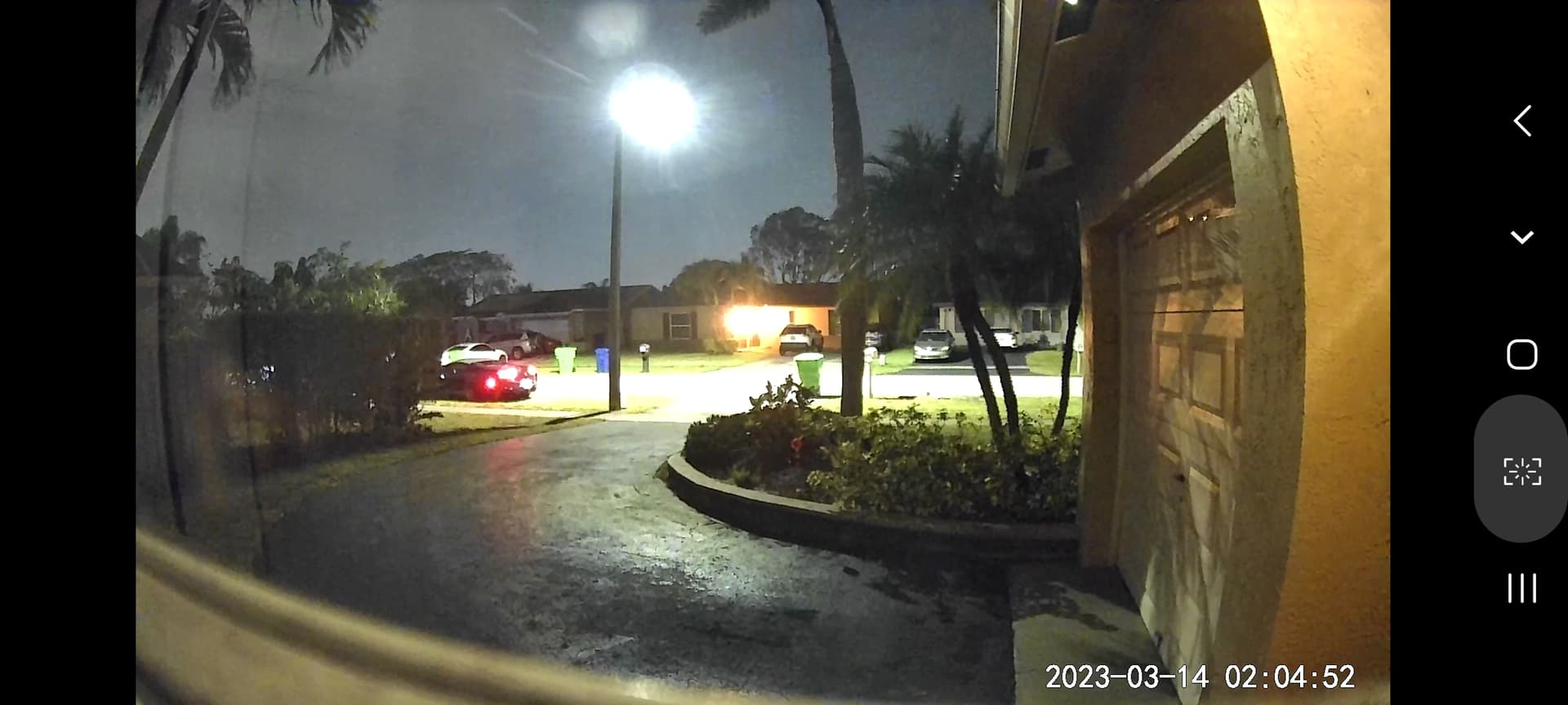

I haven’t had much luck with the sensitivity section. I left mine at 40.
Detection block is active.
Visuals are good at this time.
No deliveries tonight or this morning.
So this camera is inside your house, pointing out a window towards the street, and you really just want things as the come and go in your driveway, anot not the sidewalk or the street or the neighbors, correct?
Looks like you have a door/entry way maybe on the right?
Wouldn’t this camera be better outside pointing at your driveway (towards the left of that current angle) vs. towards the garage door where it is now?
I have 3 classic cars – I put my cameras IN the garage, and the doorbell captures outside. I also put one pointing toward my garage door from across the driveway similar to your setup. Bet it is hard backing a boat into that driveway.
I have another camera, also inside with a slightly different angle of the same view.
I can see the deliveries made on both cameras. I only want to see part of the garage to make sure it is closed. Personally, I like my cams inside where power is conveniently inside.
