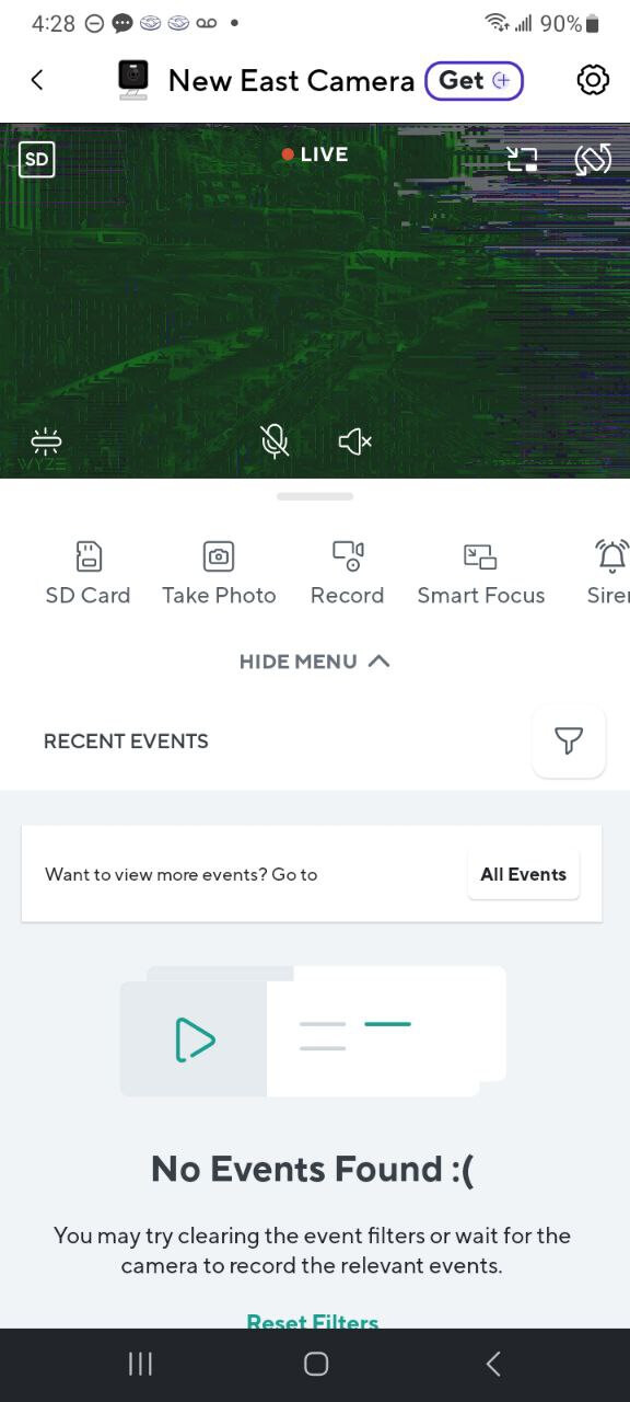

Cam v3 Pro has only good image with 360 resolution
SD and 2K are broken. What’s going on with this?
First guess would be crappy WiFi signal resulting in only the low bandwidth able to get through.
I have the camera inside on a Mesh network, and near one of the APs.
In addition, plenty of 4K TVs in the house have no trouble streaming 4K
