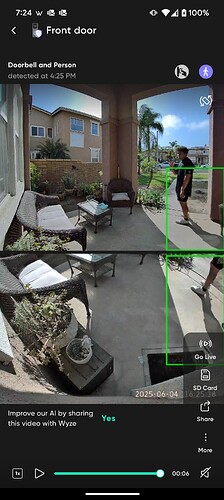

I’m having issues where I had to activate motion tagging to ensure I wasn’t getting cut short due to non movement. I have confirmed the cameras settings are set to give minutes of recording time and are on the CPU plan. I’m still getting really short events. I didn’t have this issue before. It seems like there has been a change to reduce cloud recording. The setting where if movenent isn’t detected it stops recording may be culprit, we should have a minimum recording time , period. Hence why I activated motion tagging, to prove it’s getting cut short, but it still cuts the video when the subject is still moving. It’s frustrating to say the least. Also, it’s not giving the pre-record time included in the cloud event. Some events are longer, I got up to 30 seconds and there was a long time between movement. But mostly my recordings are getting cut short. What’s going on here? Also, maybe able to report (share) this issue to wyze with some description in the app and not just AI events.
