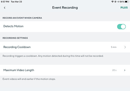

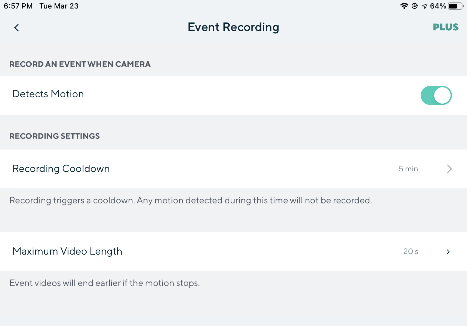

Just added Cam Plus annual subscription to my Wyze Cam Outdoor yesterday. I can toggle on Event Recording (Detects Motion) just fine, as you can see in screenshot #1. And I can toggle on Notifications, as shown in screenshot #2. But under “Notify me when”, I cannot toggle on Wyze AI Events (grayed out). Is this feature not implemented yet? Using Wyze app V2.18.23 and WCO firmware 4.17.1.35 if that matters. TIA

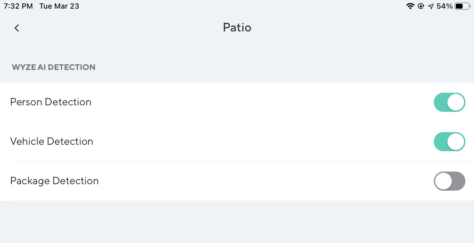

Double check your settings and make sure you have activated the WCO under Account > Services >Cam Plus > Outdoor Cam and also toggle each AI Detection on.
Thanks for the reply. Just checked and all toggled on except Package Detection, as shown in screenshot below. I’ll toggle that on now and see if that makes a difference.

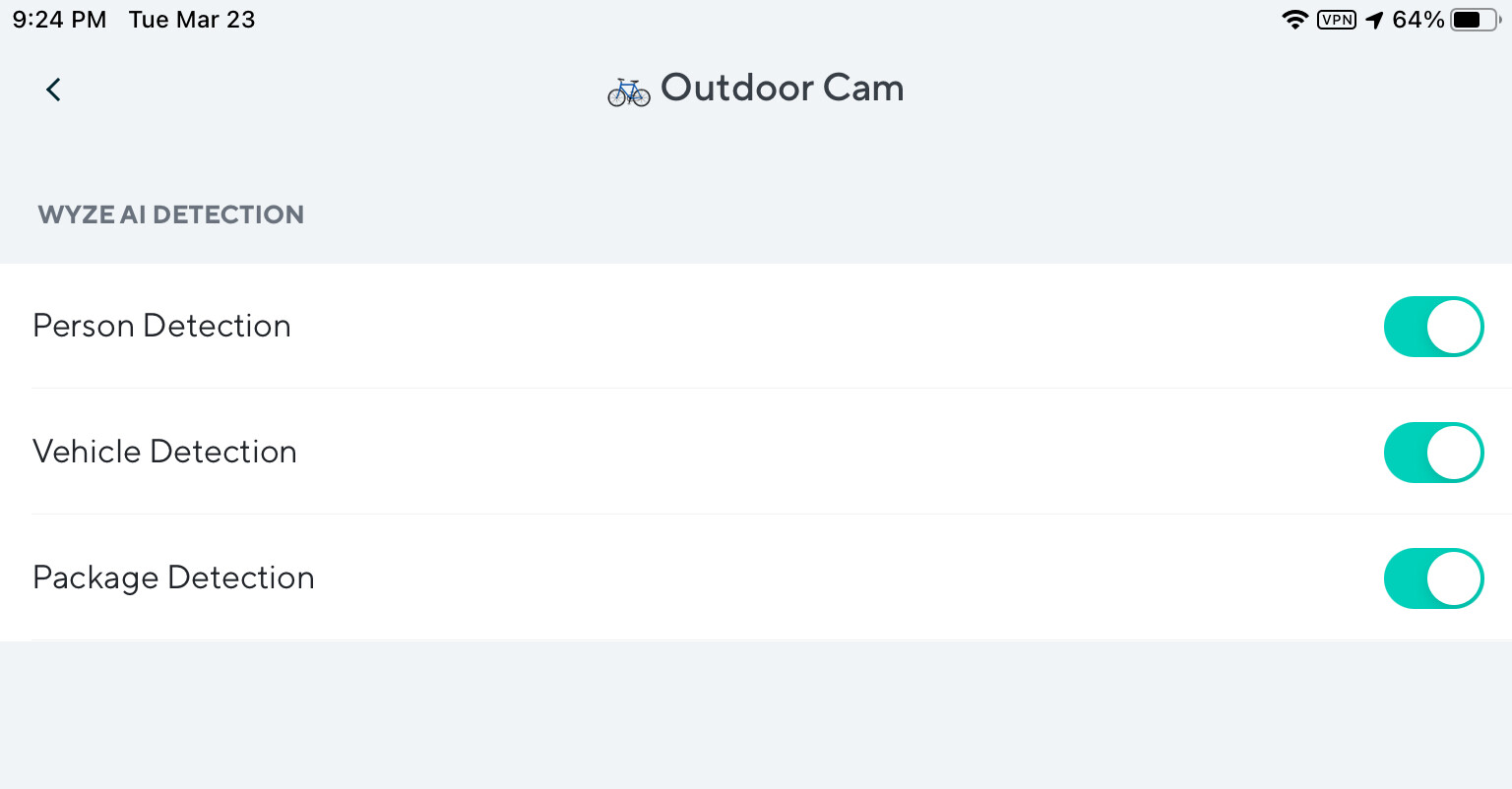

No luck. Just made sure all three Wyze AI items toggled on, yet the Wyze AI Events toggle on the Notifications screen remains grayed out. Note that I’m getting “Complete motion capture …” event notifications, it’s just that these toggle settings in the below screenshot are always grayed out. By the way, I need bunny, squirrel, bird and raccoon detection. Maybe I’ll add that to the Wishlist. /s
