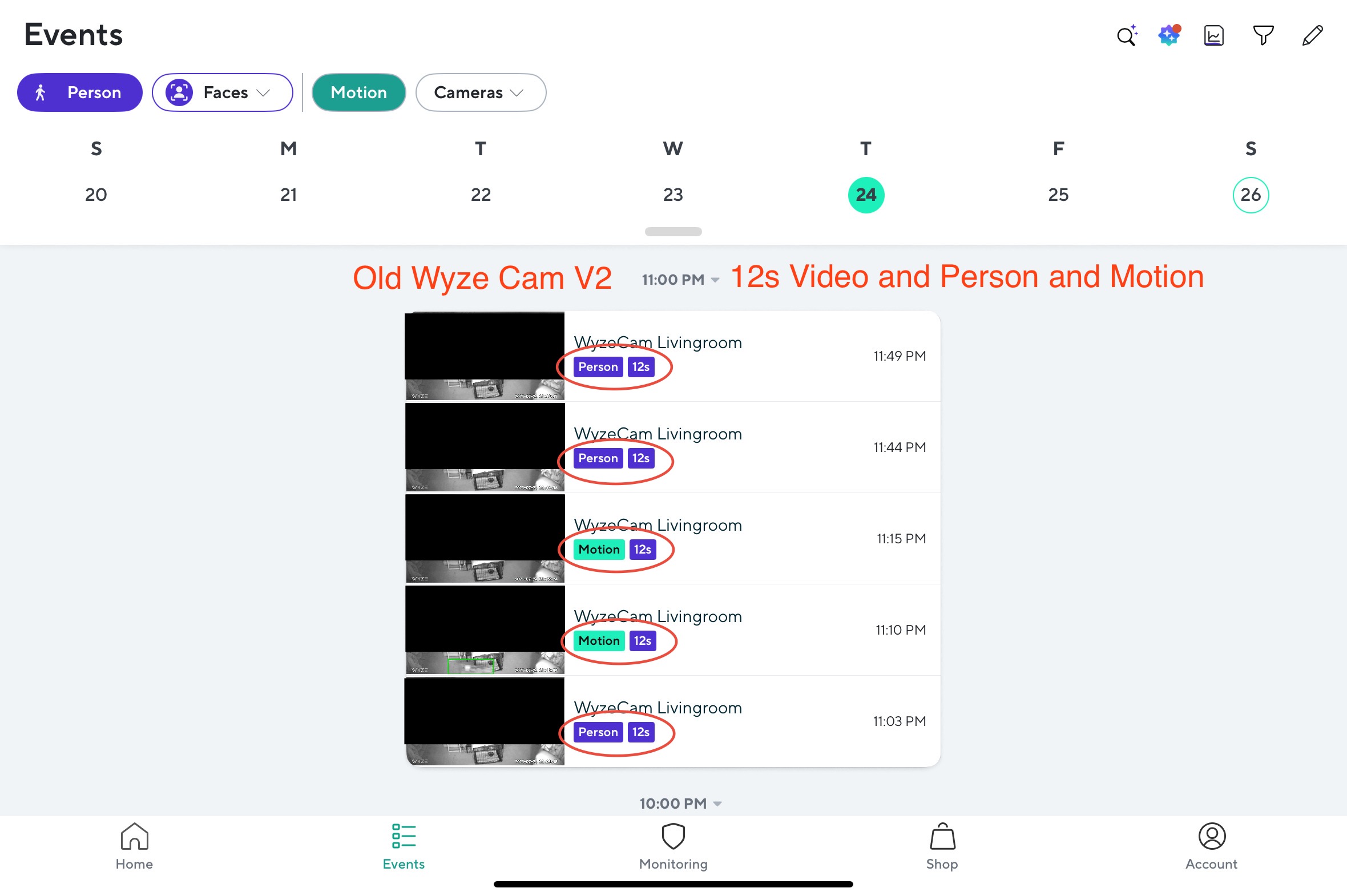

The V2’s still have the setting for “Person Detection” and Motion, and record the 12s videos every 5 minutes. See attached picture.

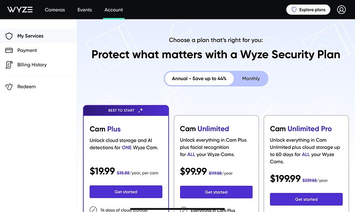

Looked at that before creating the post. Cam Plus Lite does not even show as a Service anymore under My Services. All that shows is the paid services you can sign up for.
Never had to in the past with the other cameras. It even mentions on the site no need to opt in each camera. Also as mentioned to Crease, Cam Plus Lite does not even show as a service anymore under My Services.
Can you post a screenshot of where you are seeing it under My Services? Thanks in advance.

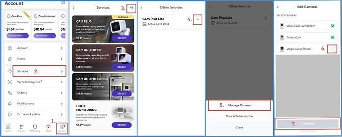

Go on your Wyze app and select Account > Services > Right arrow on the top right > Other Services.
Cam Plus Lite should be there. Press the 3 dots next to it and press Manage Camera.

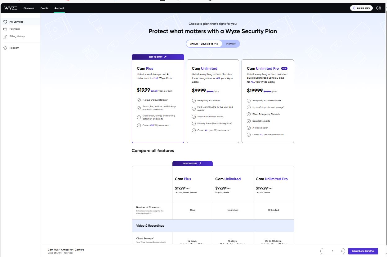

Make sure you are accessing your account through the web site. Here are couple of screen shots.
Just logged in and find the same…

Using the app try the following:
  1. Go to accounts.
  2. Select services.
  3. In upper right corner select the right arrow with three vertical lines (hamburger).
  4. If your account has “Cam Plus Lite” it should show here.
  5. Select the three dots.
  6. Select “Manage Camera”
  7. This should give you a list of your available cameras.
I have 1 V2 and 4 V3 with two of the V3 having “Cam Plus” but the remaining cameras being selectable for "Lite.:
Hope this helps.
Dose not show as mentioned. Here is another screenshot of what it shows. It only shows services you can sign up for.
Thank you @grapefruityoda and @homanfankan. That was the solution. Even thought it does not show on my Account, Services Page on their webs site it does show in the app by clicking oh that “hamburger”.
I never noticed it. I figured it should just show up under Services as many others said in other posts and that is what their AI Chat kept saying. You are the first two that mentioned the hamburger.
Thanks again. I put together a set of screenshots as sometimes people like to see pictures. All new V3’s have now been added.
