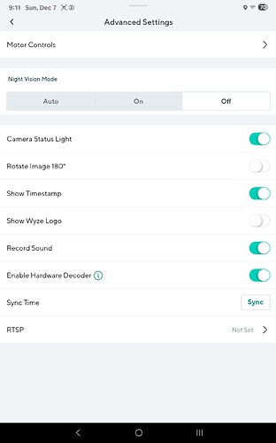

I also took a look at advanced settings and was surprised to see an RTSP selection.
This is all a long winded post that says a lot is going on and who knows where we are. I’m being hopefully patient.
