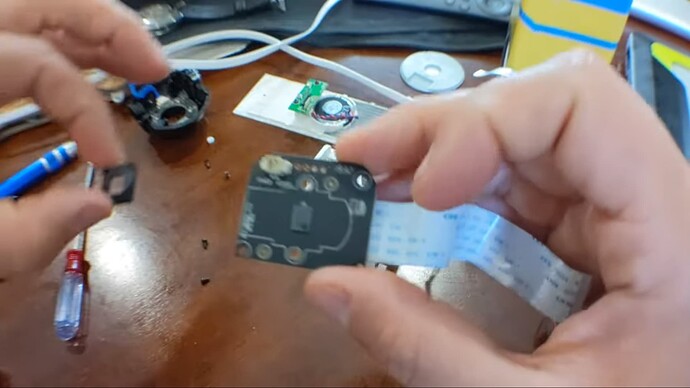

My 3 year old V1 Cam Pan image quality deteriorated over time to a yellowish foggy image. Referring to the linked video for disassembly instructions, I discarded the round clear plastic part which protects the image sensor and the image quality is very good again, almost like new. At about 15:50 minutes in the video the you can see the round protective piece is held under the squarish black rubber gasket and sits atop the image sensor.
A while back, on a V2 cam, I had attempted to clean the round protective cover but the results were not good, and the cameras work without it, so just remove it if your problem is foggy yellowish image quality.
