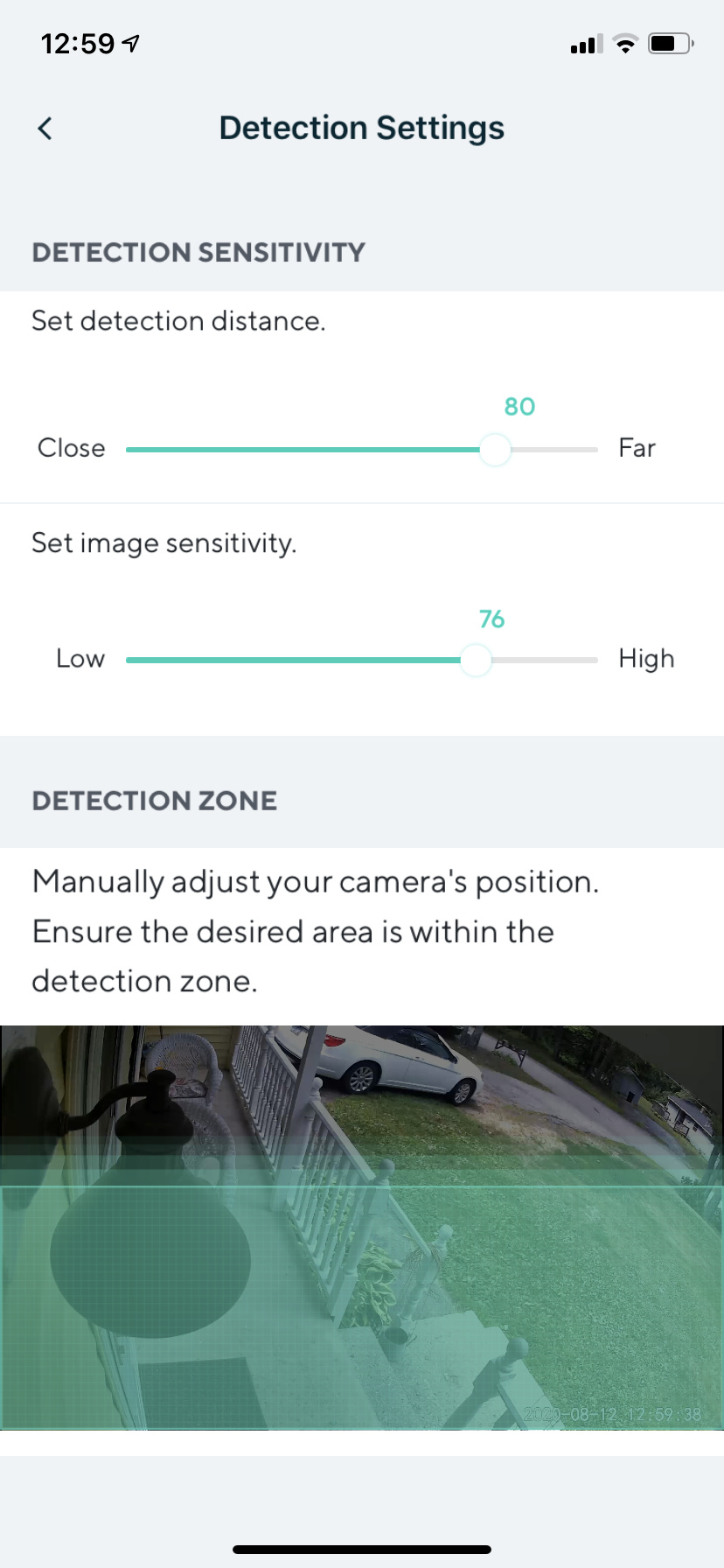

But is this right? The PIR zone is only the green section shown in the photo I attached? You would think it would cover the whole viewable area shown.

yes that is correct, the PIR has a slightly lower view than the camera. it is by design.

Looks like it might be working now with your help. The key was the green zone. My camera is mounted with the magnet flipped down and reoriented on an Eave because of needed view down a side yard. I still can’t replay live view but that may need an SD card.

This is a very inaccurate depiction of what the sensing zone actually looks like. It implies that the detection zone is equally sensitive in all areas, which it is not.
Wyze like all PIR sensor manufacturers has to know what the actually detection zone looks like, but it appears they are not willing to share the information.
To get an idea of what it actually might look like: Google “PIR detection zone” and select images at the top of the results
