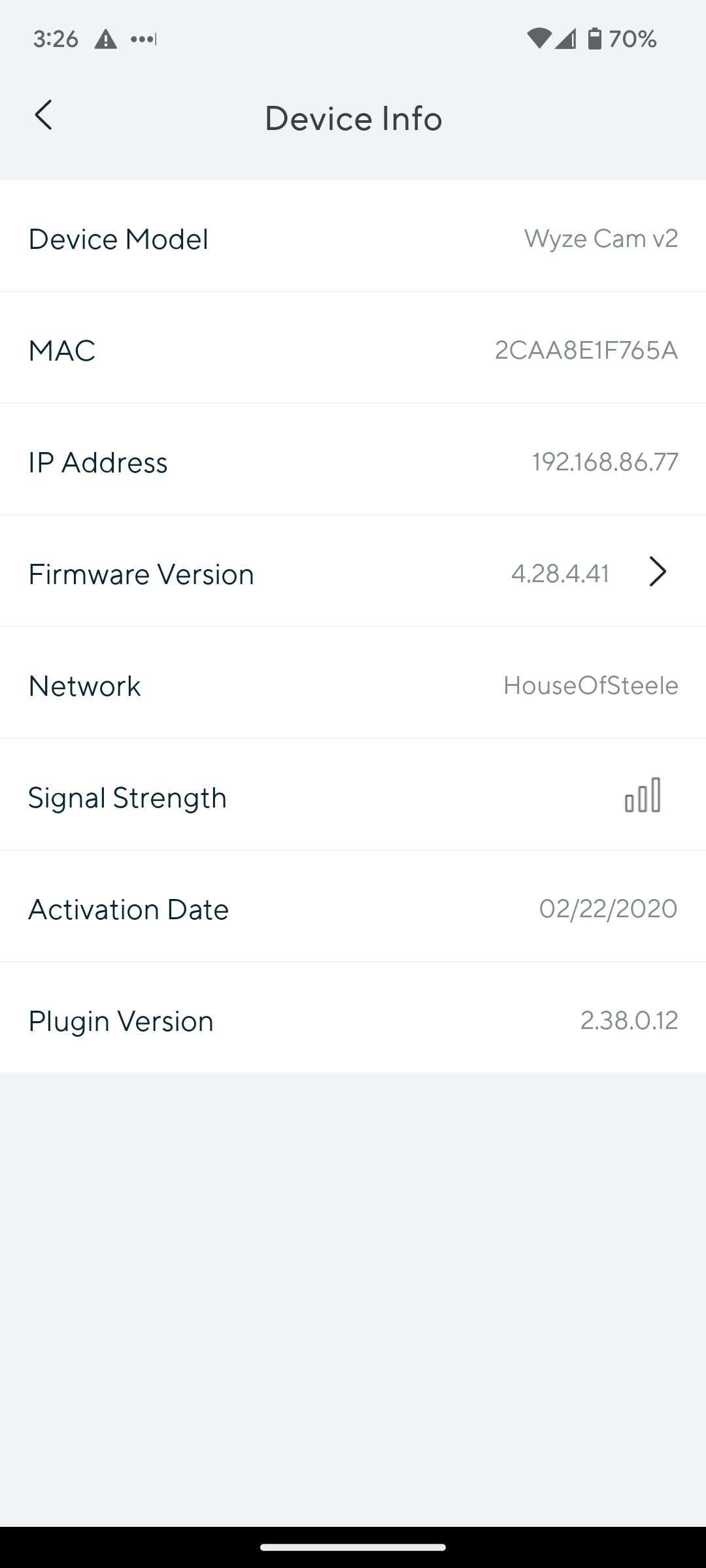

Restarted by unplugging and plugging back in
Can you try the steps provided. Looking at the image you provided, it does not appear to have a signal. 3 empty white bars are shown.

Looks like it is actually v2. It is not accessible. I got my father in law to reboot remotely. 900 miles away. But reflashing is a bridge too far.
I haven’t checked the numbers but app says it is latest rev for that device
Just looked around, this is the RTSP Firmware, correct?
Asking because the Latest Cam V2 FW is 4.9.9.1574 (December 7, 2022)
Possible. But it has worked since I put it on. Nothing changed on my end :slight_smile:
