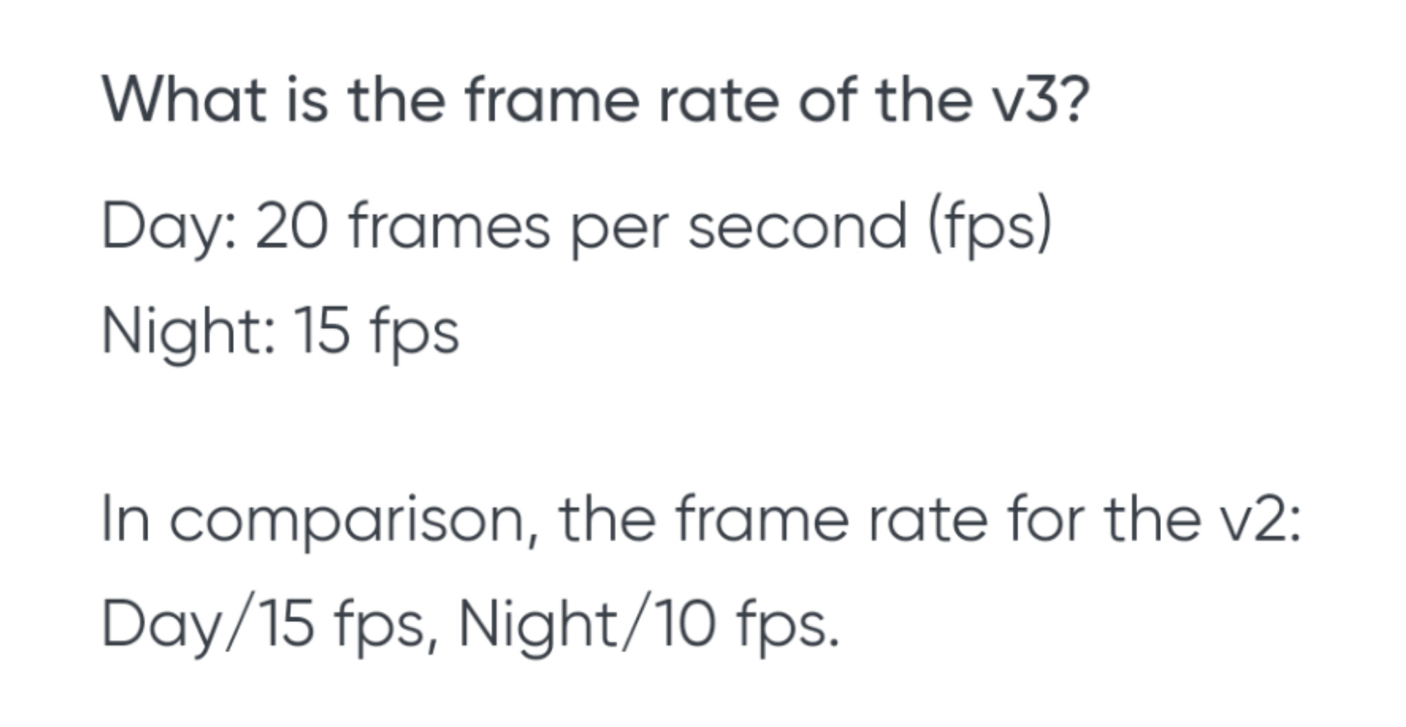

I see in the shot it’s showing 6.32 FPS, likely nothing is moving. Does it do full out 20 FPS on night vision or does it drop down by 5FPS? i.e. 20 FPS no matter day/night, nightvision on/off? Did you try to set it to night vision OFF and set it for DUSK mode? If you have any light in the back yard this will look good.

The specs for the v3 fps normal rate per the shop site:
I wouldn’t think RTSP would change any of that.
Thanks! I have the FPS restricted down in iSpy to 6FPS unless recording. Not sure on the total FPS in night vision mode. We are out in the country, so there is very little ambient light, other than the moon & stars. We have no toddlers here but still have alarms on the exterior doors and a Pool Guardian on the pool. Local laws say the pool has to be fenced, any gates have to open outwards, and must close & latch on their own. There are some distance from grade requirements for the latches and for picket spacing, but it is a solid fence so the spacing rules didn’t apply. The pool area is entirely fenced, but it is a small area of our ~ 2 acre yard. It passed the local final inspection with no issues :slight_smile:

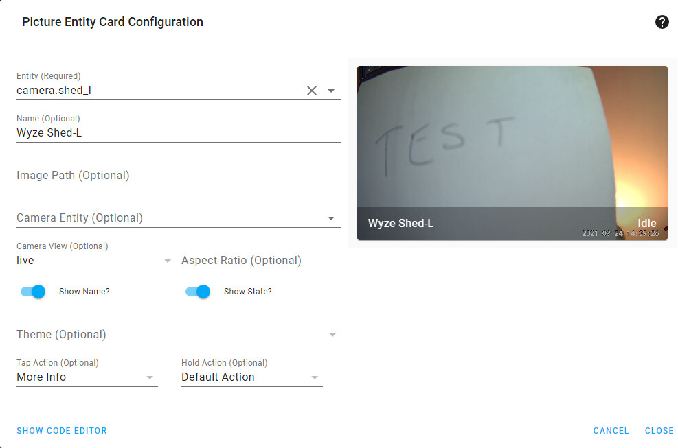

Now displaying in Home Assistant:
configuration .yaml stanza:
# Wyze V3 Shed-L
  - platform: ffmpeg
    input: -rtsp_transport udp -i rtsp://userid:password@192.168.210.44/live
I did not try tcp. I used udp based on the recommendation (Beta Testing for Wyze Cam v3 RTSP Firmware Now Available! - #24 by juched) from @juched
lovelace card:
