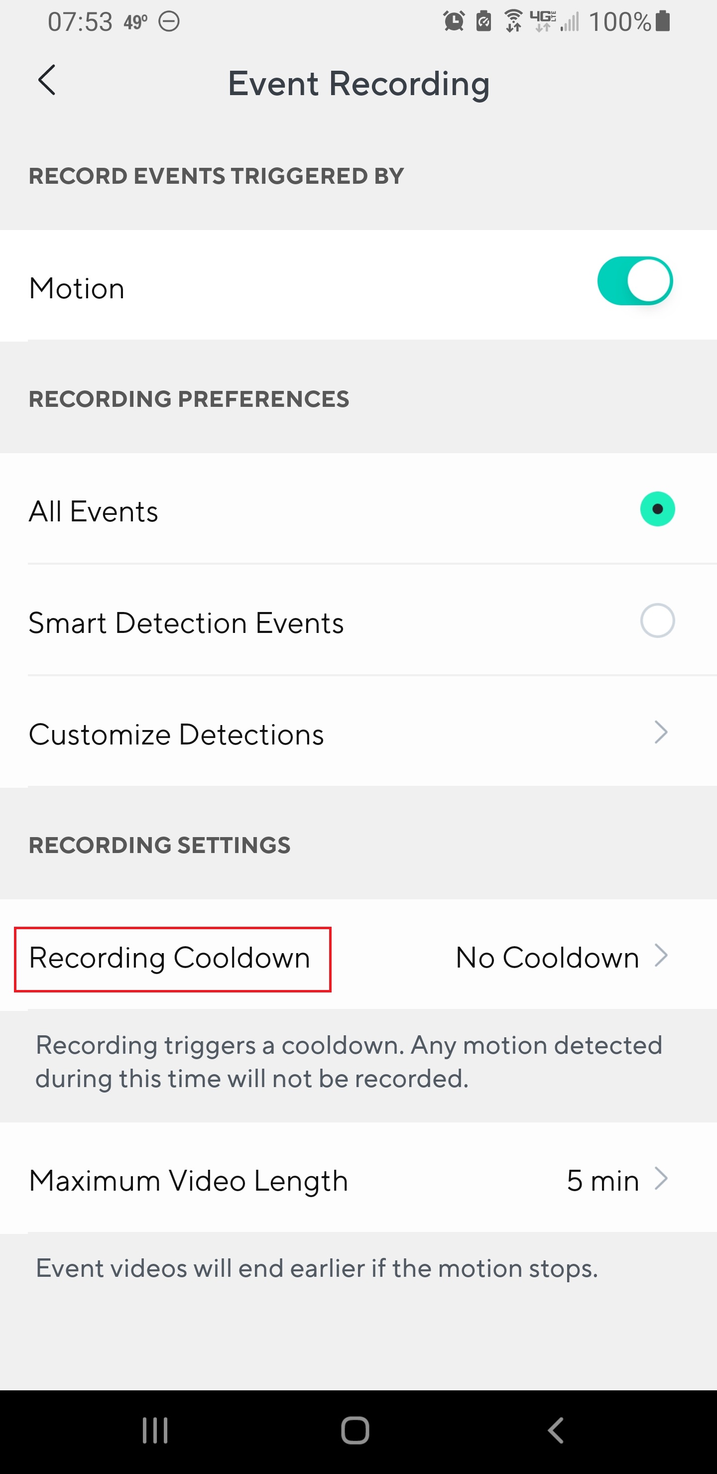

Does that cam have a cooldown setting? I don’t have that cam. My old WCO v1 battery powered cams have a setting for the cooldown period which just got fixed this year after 1.5 years of being broken. It can be set to No cooldown period once again.
Yes, Battery Cam Pro has a cooldown setting:
Thank you both. Yes, the cameras do have a cool down period that was set at 5 minutes. We put it to no cool down and that resolved the issue. Really appreciate your help
