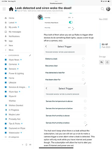

Going back thru Wyze leak sensor previous posts I found this which looks very helpful… I am just reading thru the posts and automation info
That would mean you need the Home Monitoring service, a priced service. The sensors and hub were sold stating that Home Monitoring was NOT needed. I have no interest in the Home Monitoring service but I do want to be able to silence the alarm from my Leak sensors.
