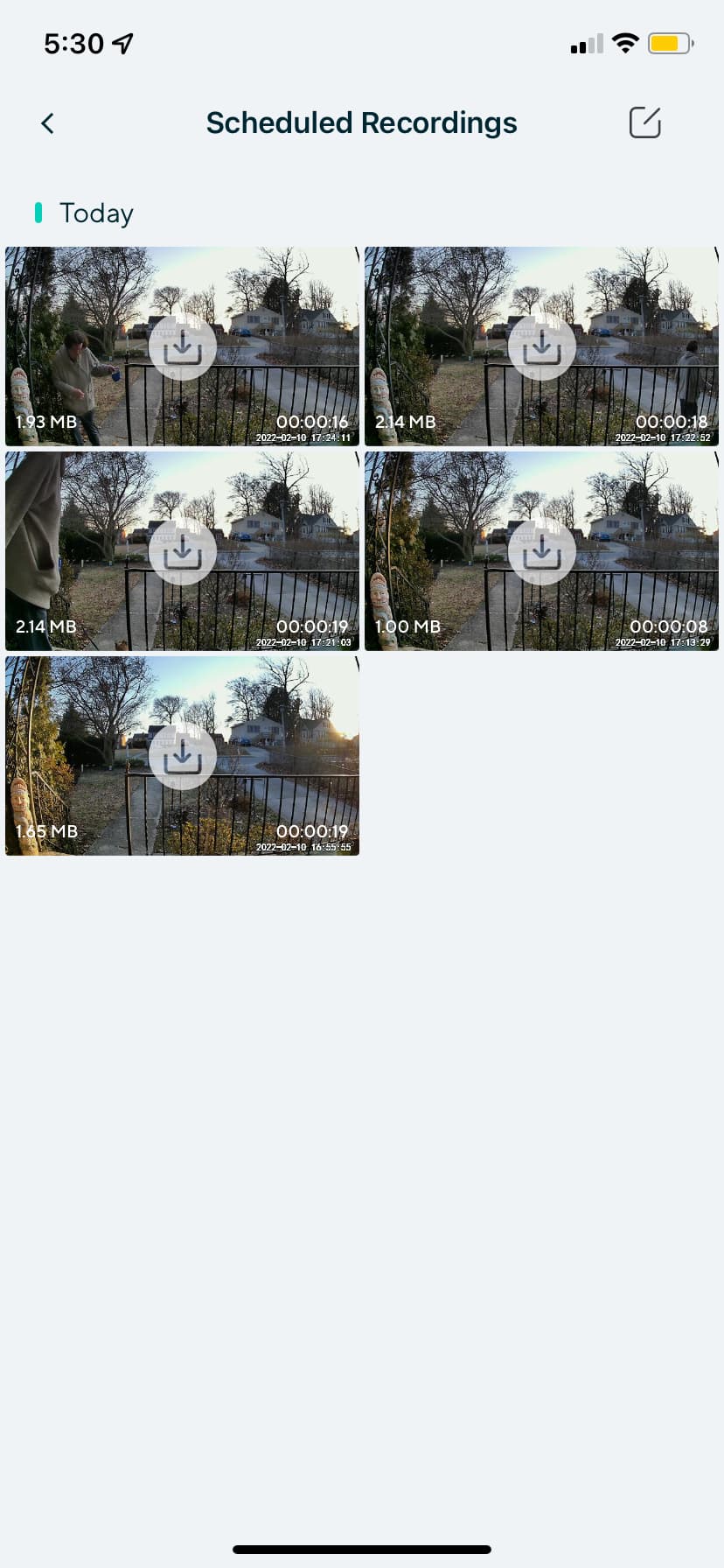

I have a tiny foster dog. I took outside. I walked it in front of both cameras. Not even intentionally When it hit me that hey I should check and see how long they recorded. I saw nothing.
The trash men today. Scheduled recording caught them driving I the street but the event did not. That was the kicker for getting cam plus. After a couple weeks ago the trash men broke my mailbox and I had no video of it and that’s a $400 replacement now. I’ve been watching and paying more attention to how and what the cameras are getting. I’m home all day. So I know what should be recording. Granted I probably have more videos per day than average but the camera especially with plus. Should be able to capture everything
Since you have cam plus do you have your cameras set for “No Cooldown” ?
Yes I have it on no cooldown. I was just out there again with my dog. For over 5 mins.
The camera on events only caught 12-16 sec but magically the scheduled recordInfo caught 16-19 (3videos) recordings.
