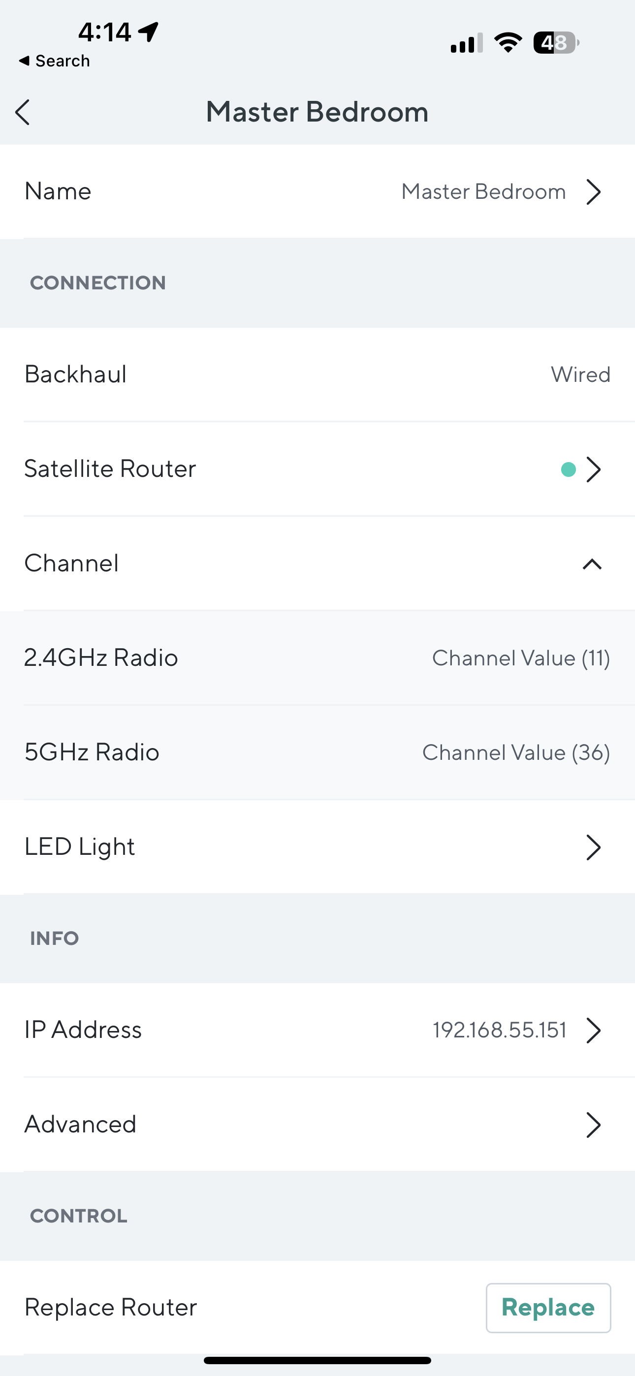

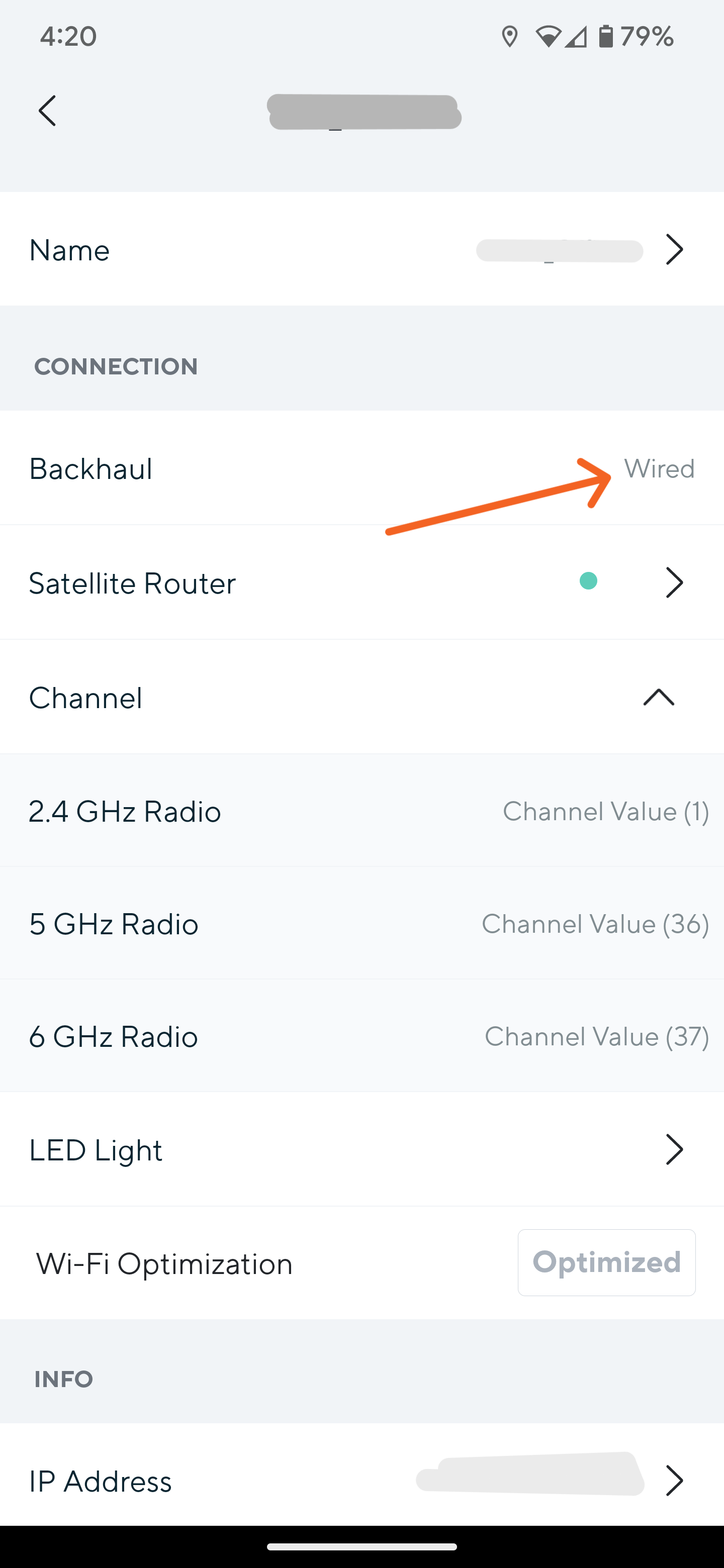

Thanks for the tip! I will go try that. Is there a way to verify it’s actually using Ethernet when you move it back ?
Yes, it will take a bit to connect and switch to wired. Then go into the App, select the Router and then tap on your node. you will see Backhaul listed It will say Wired like this image:
