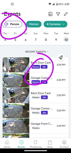

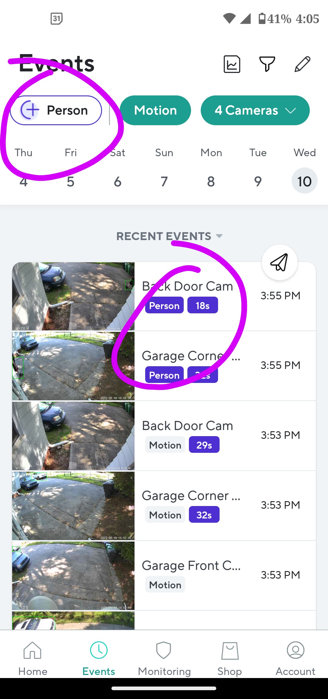

Here is a new twist… I just went back into the app with all filters cleared to test. I clicked on the Person quick filter button and got this hot mess:
Had to close the app and reopen for it to reload the default Person \ Motion \ Cams.
Then I select Motion. Correct me if I am wrong, but with only Motion selected, shouldn’t all the AI tags be hidden?
But then when I select Person, all the Motion events disappear.
Unselecting Motion changes nothing. Same as it was with Person and Motion selected. Unselect Person and we are back at square one.
