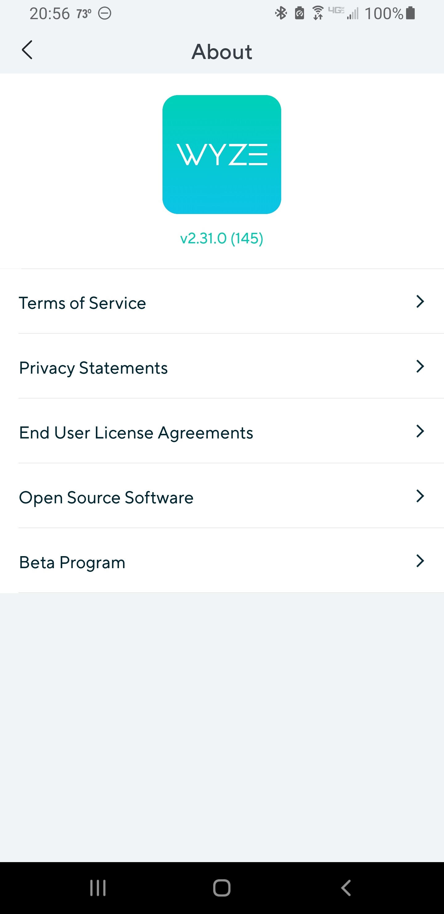

The link I posted above points to a Google Play Store copy of the current 2.31.0 (145) production app for Android. You didn’t need to reset phone and wipe cache partition. I just uninstalled current 2.32.0 (b148) beta from an S9 running Android 10, installed from the mirror .apk and it’s running fine.

That message means your uninstall of the beta app didn’t work. How did you go about uninstalling?
I just downloaded wyze app from a random website, installed and everything works again. As others have stated, you didn’t uninstall the software if it says your currently installed version is newer. (I mean the error message is self explanatory)
