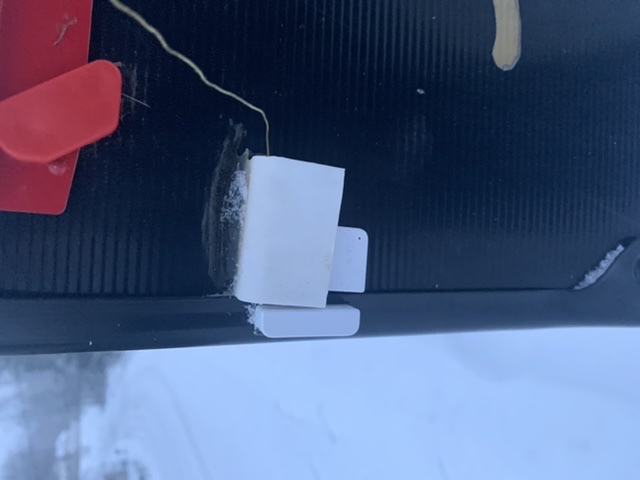

I was gonna put the sensor inside mine, but I have an extra large mailbox and get a lot of packages. I didn’t think it would last a week with boxes getting shoved in. That’s why I mounted my contact sensor outside the mailbox. I cut a piece of silicone about the size of the sensor from an old mold and siliconed that to the mailbox covering the sensor. It protects the sensor from rain and works like a flap that I can lift to expose the sensor for battery changes.
It’s been working well for several months in rain and now snow.

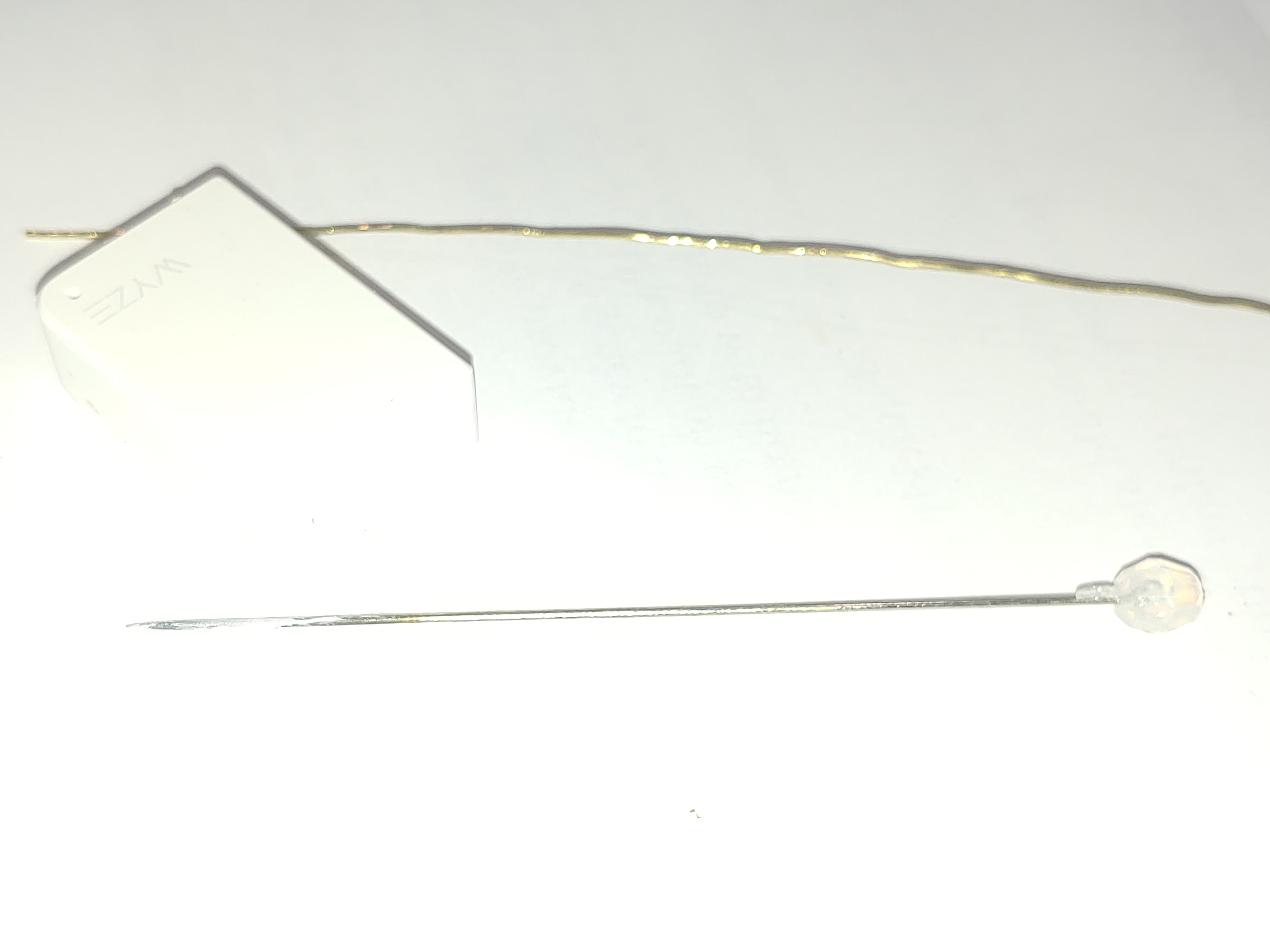

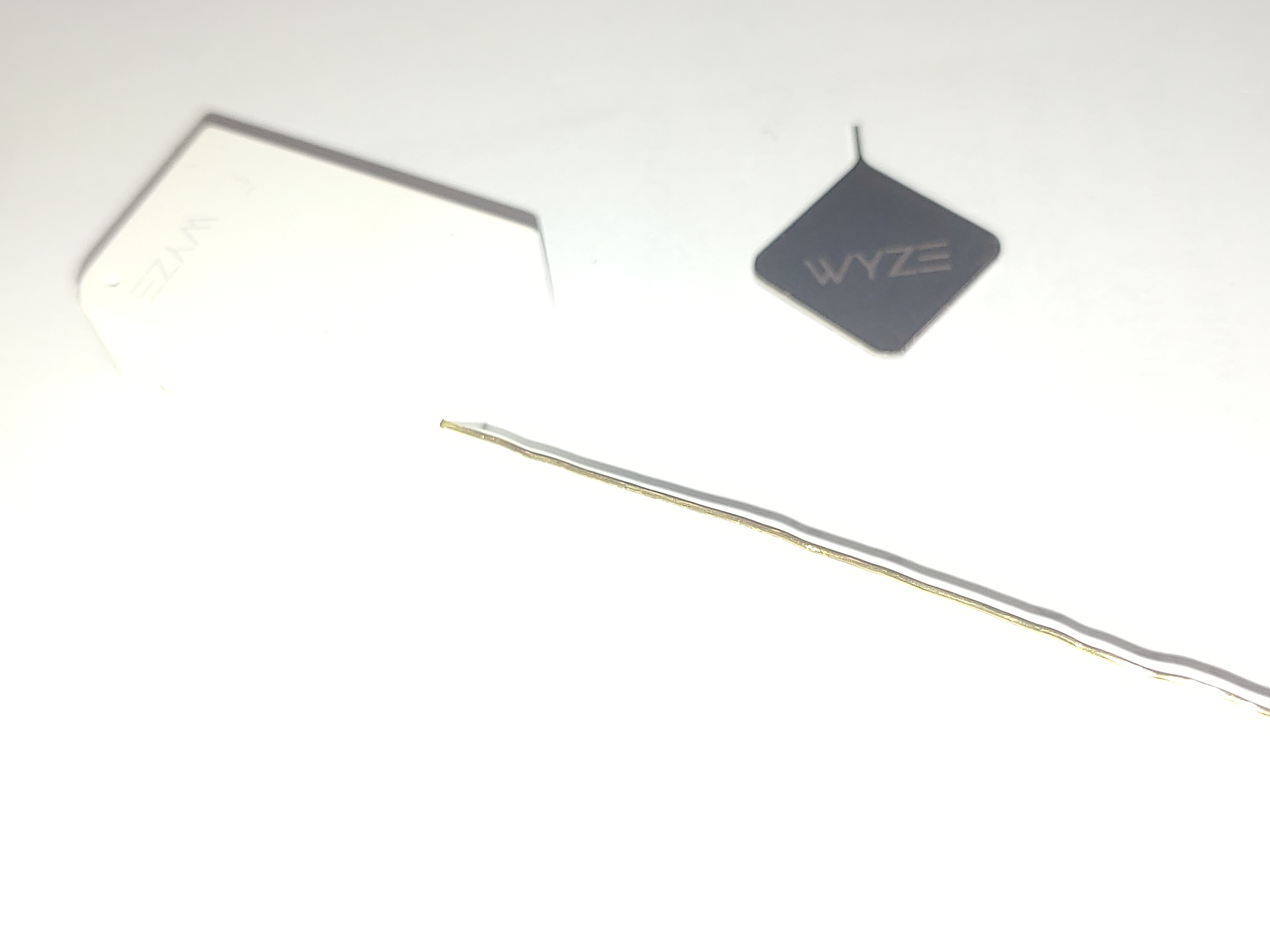

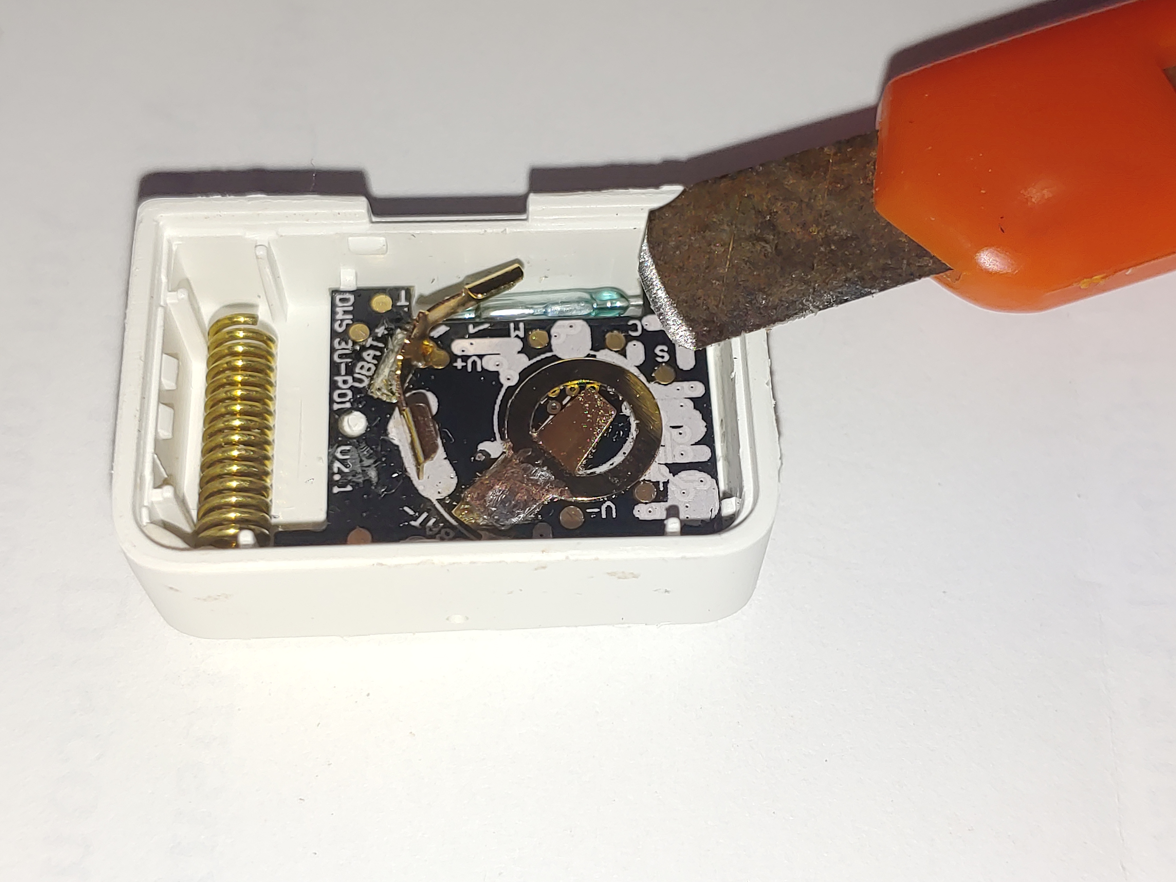

I also opened the sensor, uncoiled the antenna, and routed it outside the sensor which increased the signal strength. The wire is about 5 1/2 inches long once uncoiled.

I simply attached the contact sensor to the side of the mailbox next to the mailbox door and attached the magnet part to the door itself. Then to help protect it, I took a scrap piece of silicone rubber and glued it above the contact sensor to cover it from rain. It acts like a flap that I can lift up to get to the sensor for battery changes, etc.

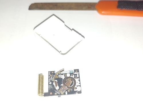

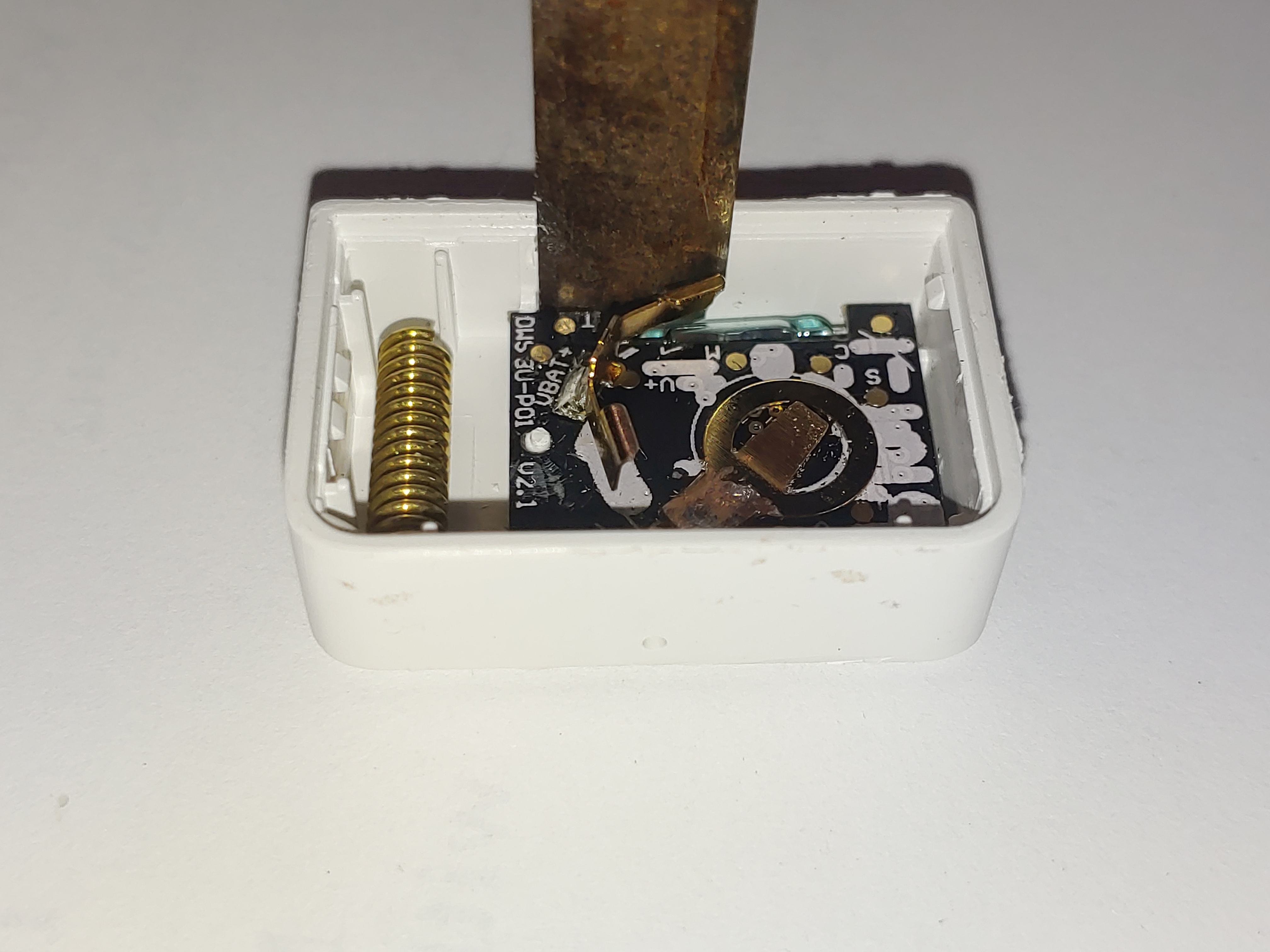

It was working okay most of the time, but occasionally would show offline, I think due to distance. The camera with the bridge in inside an enclosed sun room porch and is at least 75 feet away if not more. So I opened up the sensor and found the antenna is coiled up like a spring to fit inside. Antennas need to be a specific length to match the frequency. I uncoiled and straightened the antenna wire, which once uncoiled was about 5 1/2 inches long and made a slot in the sensor case so I could extent it outside the sensor housing. then added a bit of silicone around the wire to seal it So basically, I now have a contact sensor with a 5 1/2 inch wire sticking out of it. It’s a pretty stiff, but thin wire, not soft copper.
After doing that a while back, it hasn’t failed or dropped offline once, except when all the Wyze sense dropped for other reasons like the system being down a week or so ago. I have a good signal with 2 out of 3 bars shown in the settings and it was only 1 bar before my mod.

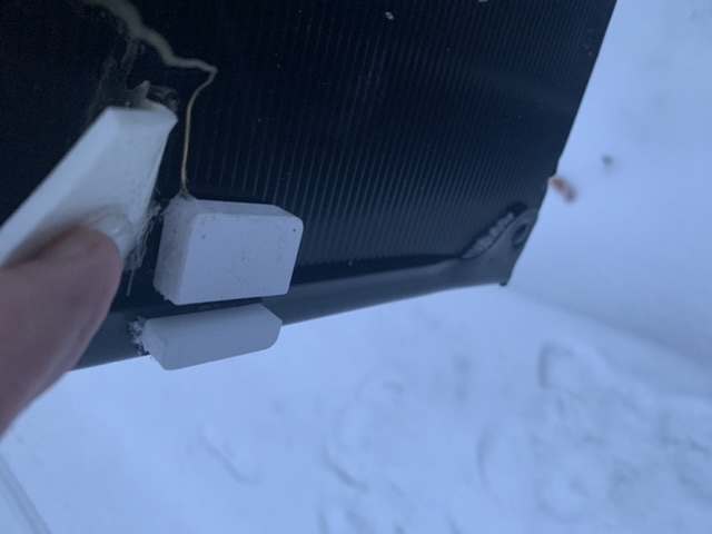

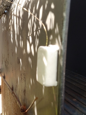

I took a couple quick photos of my mailbox sensor. You can see the antenna wire that I uncoiled and routed outside the sensor, and also the white silicone rubber weather cover.

Thanks @raym64! Clever mod. I appreciate the pics and extra explanation.

Have mine mounted on our metal mail box with your mod.
Before it had 3 bars before mounting it to the box then it when to off line state.
With your antenna mod it show one bar but it better then none …and it’s working… Alexa says, You’ve got mail …

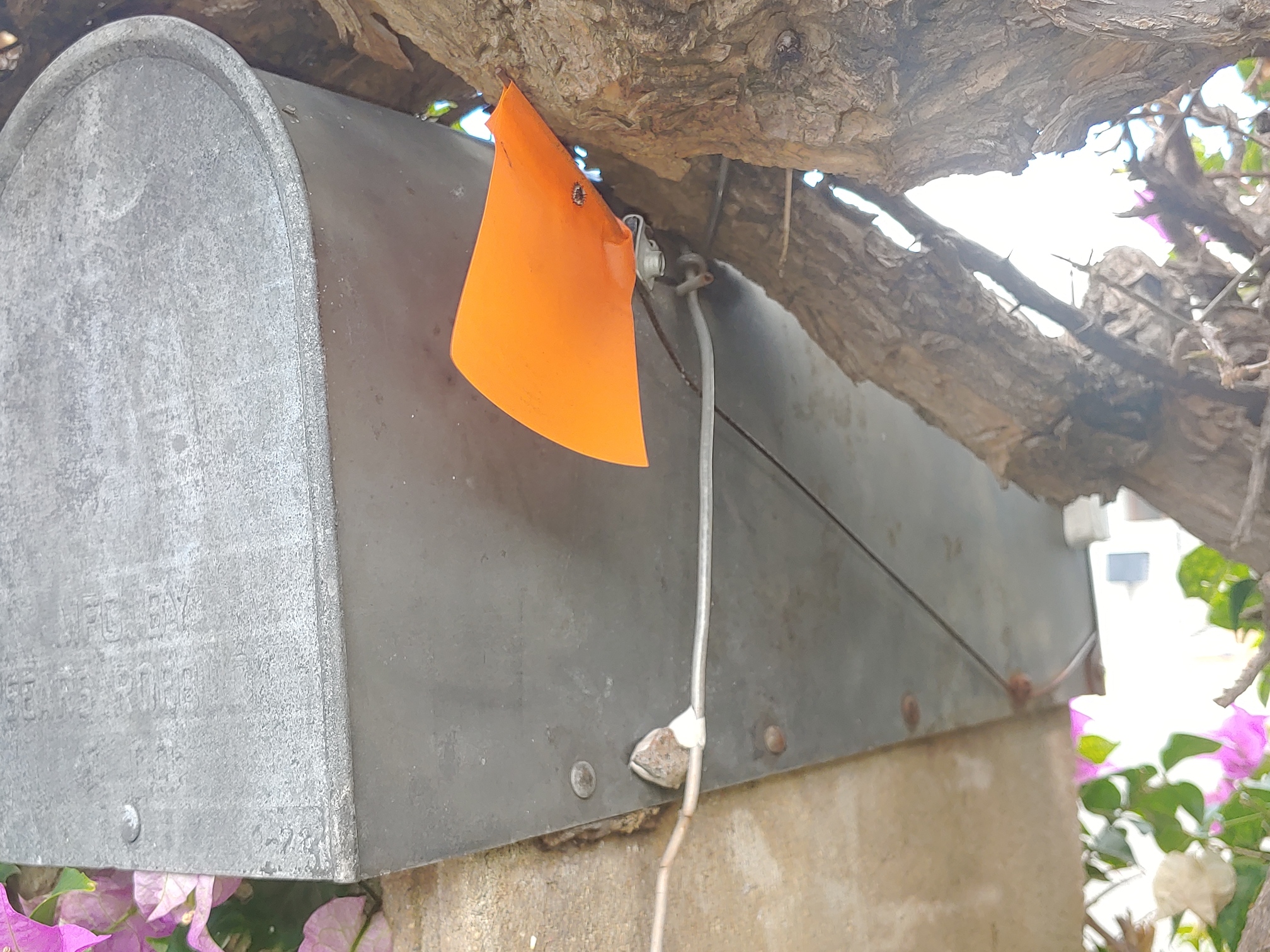

Completely Water Proof the Contact Sensor with Scotch Removable Mounting Putty. Removed the factory mounting tape and warped the entire case with it … not sure how it will work/holdup in the snow though?
The last pic is an old mod I did with a landscaping flag that needs to be reloaded after I pickup the mail. I can see if the mail arrived just by looking out our living room window to see if the flag dropped. Great mod for people who seem to have problems and give up on the Wyze sense …
