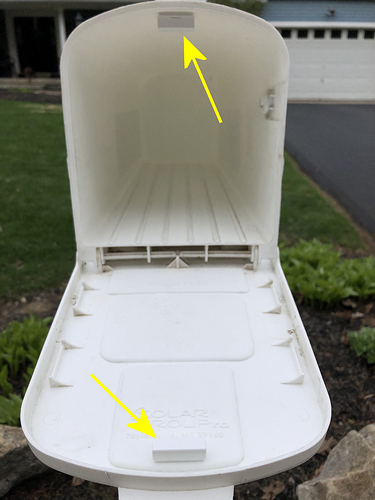

Installed a Contact Sensor inside my mailbox today. Now I get a notification when the mailbox is opened (and closed) so I know that the mailman has made the delivery.
Below is a photo of the installation. The yellow arrows indicate the sensor locations.
Very nice, yeah that’s where mine will be going… sensor 1 in mailbox… sensor 2 garage door! Impatiently waiting for add on kits…
Looks like that mailbox is plastic… mine did not work because it is metal.

They don’t seem to be saying that officially but it’s at least 50’ from my cam (inside the house) to my mailbox outside and it’s got one bar of signal strength. Walls, materials, etc. will all effect the distance.
I also have a metal mailbox and it seems to be working fine. :thinking:
That’s very true for a metal mailbox but those little sensors only have one tiny small hole to activate them and are therefore pretty weatherproof, so you could install them on the outside of the mailbox instead

I installed mine on the back wall of a cast metal (probably aluminum) mailbox and it connected to the bridge. However, when the door is closed and the sensor is in the dark, it does not indicate it cleared. Any suggestions? Signal strength is 3 bars and battery is normal.
Hi,
I also have a metal mailbox. I have the same issue… it never clears! However… the next time my mailbox is opened, I get a notification, and that is all I care about!!! I even had my motion detector go “offline” in my app, however, again, as soon as the mailbox was opened, I received a notification! I think Wyze needs to do a little more work! The bottom line is the motion detector is doing what I want, notify me when the Post Man opens my mailbox. I am very happy. Not sure why the sensor reflects “offline” in my app, however as long as it does what I need it to do, I am happy.

Letter carrier just came and I was alerted that the box was opened. Yipee! Same as you, it never indicates it cleared with the box closed. My mailbox is some 80 ft. from the camera and the signal goes through the metal mailbox and through the brick wall of the house. Not bad.

Thanks for the info and pic. Unfortunately neither my motion nor contact sensors worked inside my metal mailbox.
I think what might be happening with your motion sensors is that when the mailbox is opened the signal can get out and maybe even bounce off the door to your house. When the door is closed the signal cannot escape and therefore the sensor appears to be offline.
