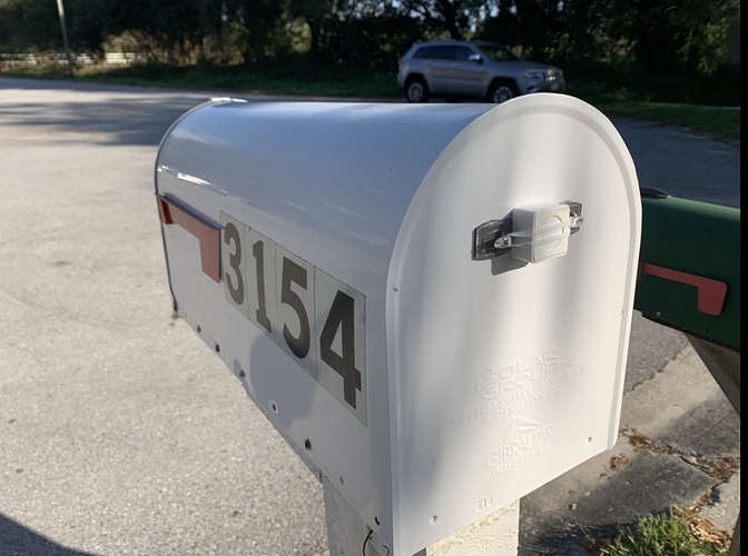

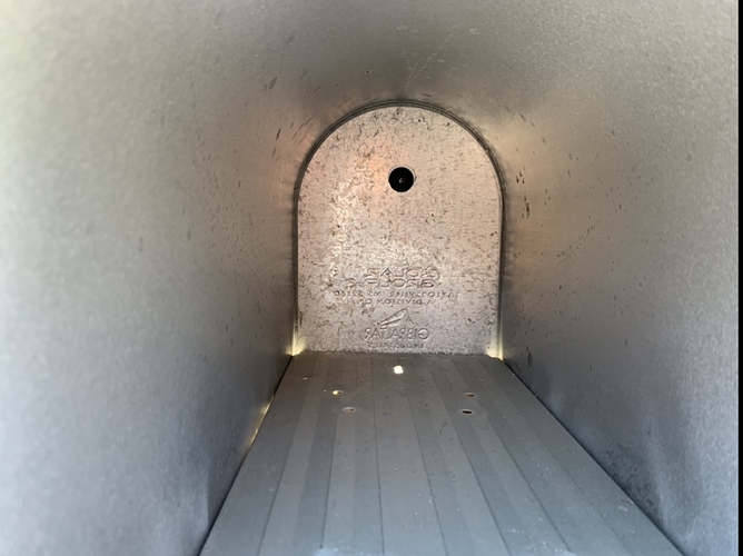

I just wanted to share one cool application I did using one of my Wyze motion sensors I mounted in my mailbox, drilled and fixed at the back of the mailbox.
I’ve seen other posts using contacts for mailbox and I tried but the range of the sensors is not so good when it is outside and even worst when installed on a metal box, so this is my solution.

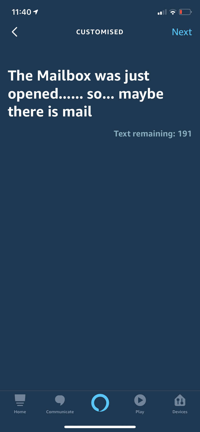

The idea was to get notifications when the mail arrives and probably monitor the mailbox for burglaries, so far I am using only to monitor my mail arrival, it works pretty well, I also created a routine in Alexa and plays in my Kitchen Dot, also at arrival by using location.
See pictures attached and the Alexa routine screen captures, I hope you guys like it.

We just had a mail thief hit our street a day ago spurring me to try again with getting the motion sensor to work inside our metal mailbox. What worked for me was placing the motion sensor inside the mailbox, near the front instead of the rear. And, crucially, using a 3 foot USB extension cable to create some distance between the bridge and the camera, presumably lessening the RF interference between the two. For everyone else trying to make it work, keep experimenting and good luck.
