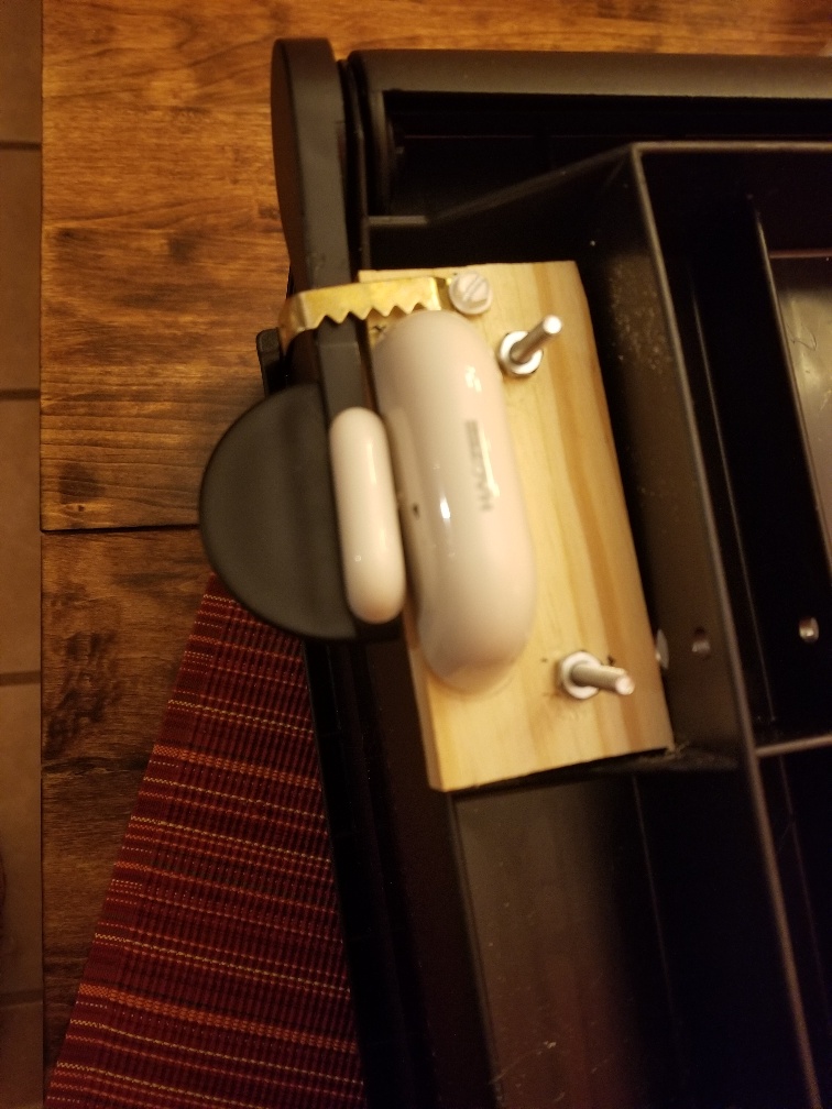

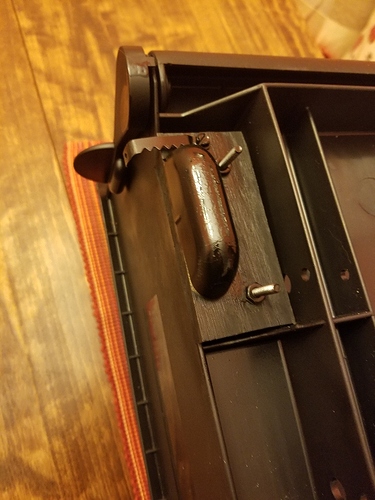

I bolted a piece of wood to the bottom. I used the included screws to attach the sensor to the wood, and the magnet to the flag arm instead of using the provided adhesive pads. I used a picture hanger bracket as a stop for the notifier arm. It worked out great.

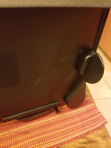

Notifier arm in the down position resting on the stop. Getting ready for paint.
Flag in the up position.

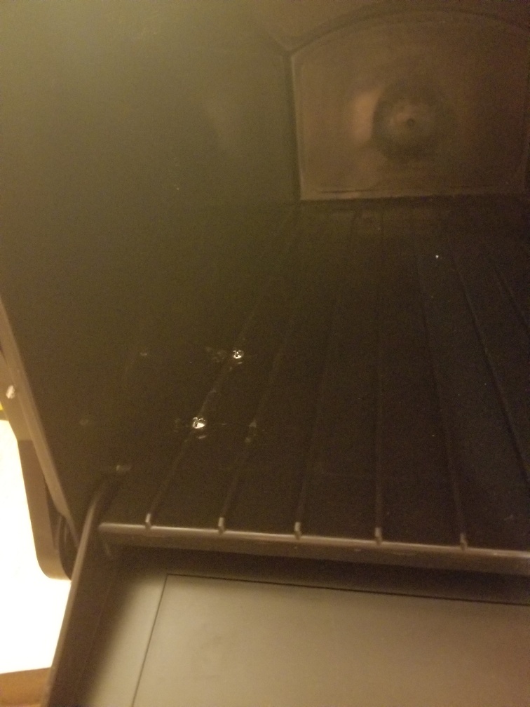

The only thing inside the mailbox are the two screw heads. I don’t expect that to be a problem.
I would have included links to the mailbox and sensor I used, but I didn’t know if that’s allowed here or not. If someone’s curious PM me. I think I covered a lot of bases with this install. The sensor is on the outside, underneath and out of sight, yet accessible for battery change. Nothing inside the box except the two small screw heads.
