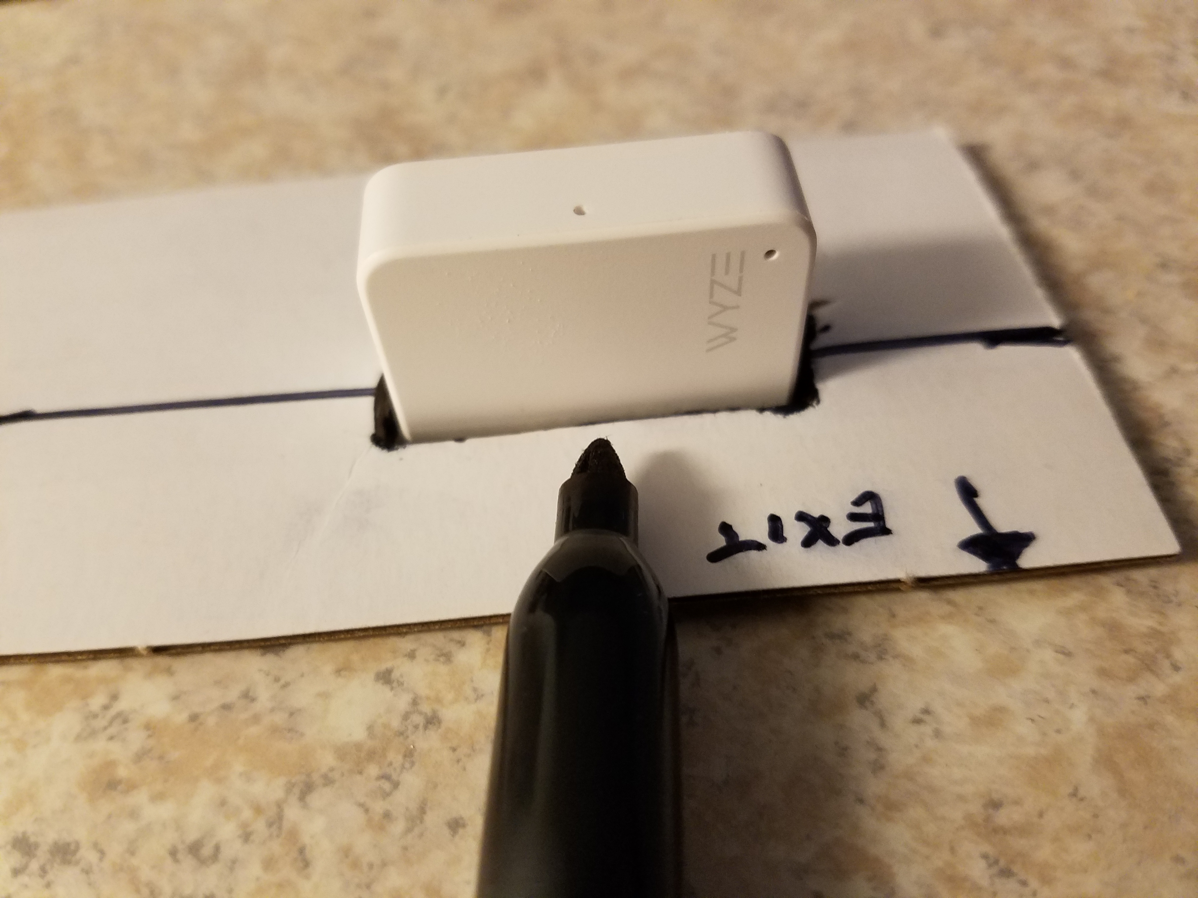

I mounted mine in the door and door jam. For anyone interested, here are the steps I followed and pics. You will need a 3/8" drill bit and drill, a business card or small piece of cardboard, a hammer and a chisel (no wider than the sensor), and either a steady hand or a depth stop collar for the drill bit. To do all this you need to remove the double sided tape from the sensor pieces.
  1. First, I got a thin piece of cardboard about the size of a business card, thick enough to stay flat (don’t use paper) and as thin as possible (maybe a business card would work too).
  2. Place the cardboard template on top of the door, draw an arrow towards the exit and one towards the inner door jam where the latch is. Flip the cardboard and just put the arrows in the same place on the same sides as the top with the same names (jam/exit). This is important that both sides of the cardboard are identical.
  3. Line up the card so it’s flush with the exit and jam sides of the door. Make a tick line halfway between the exit and entry side of the top of the door on the cardboard. Use a straight edge to make that line straight across the template cardboard. (I did all this at once so my template is already cut out in pics)
  4. Place the flat side of one piece of the sensor about an inch or so from the jam side of the door. Draw the outline of the sensor as shown. Cut out the sensor template hole with an exacto knife or utility knife. Put something underneath that can be sacrificed so you don’t damage something valuable.
  5. Clean the top of the door of any dust or dirt so it’s clean. Place the template on top of the door with the markings facing the appropriate direction (depending on whether the door is left handed or right handed will determine which side of the cardboard you use), Use a sharpie to mark the template on top of the door.
  6. Do the same thing on the top of the door frame above the door. Use the opposite side of the cardboard template for the frame from the door top. Use the sharpie to mark the template.
  7. Place the depth stop collar on the drill bit equal to the depth of the sensor (see pic). Do not use the point of the drill bit as the starting point, start where it gets wide. Make sure the collar is secure.
  8. Drill out the template you outlined on the top of the door. I was able to make 3 holes, one on each end and one in the middle. Go slow and straight. Use the hammer and chisel to GENTLY clean up the hole and make is more square. You should end up with something like this when you are finished. Make sure the large sensor piece fits in here easily. DO NOT FORCE IT. If it doesn’t slide in and out with zero resistance, use the drill/chisel until you clear it out enough for the sensor to slide in and out easily.
  9. Once the sensor is in the hole and is flush with the top of the door you need to secure it to prevent the magnet side of the sensor (the little side) from pulling the big side out of the hole. I used clear packing tape. DO NOT GLUE OR OTHERWISE MOUNT WITH ANY ADHESIVE!!! You’ll need to get this end out periodically to replace the batteries. For me, clear packing tape works and because it’s the top of the door, nobody will ever see it. Here is a pic of the bottom piece mounted.
  10. Now adjust the collar on the 3/8" drill bit to the depth of the small sensor piece (the magnet) plus about 1/16" extra (will explain later). Make sure the collar is secure.
  11. Drill out the top of the frame the same way you did the door. 3 holes (left, right, center) inside the template outline you made with the marker. Clean out the extra material with a few light taps of the chisel and if need be, run the drill back and forth to help clean out extra material. Go slow since it’s overhead.
  12. Once the top side of the sensor fits in the hole just a little deeper than the door frame, you’re good to go. You don’t want this piece flush with the frame, you want it 1/16" deeper. Temporarily tape the top side and test the sensor to make sure it’s working on your Wyze app. Once you verify it’s working, remove the tape. The extra 1/16" allows you to caulk over the magnet piece and secure it. Since this side has no battery, you can caulk it in place. Smooth out caulk as best you can with fingers, a putty knife etc. This allows you to paint over the caulk and conceal the magnet side.
    20200322_190128
Paint if desired. When you need to change the battery, just pull the tape from the outsides of the main piece of the sensor. If the sensor is not jammed in the hole (remember I said it was important to go in easily with no resistance, this is why), it will come out with the tape or a thin object like a paperclip.
