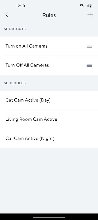

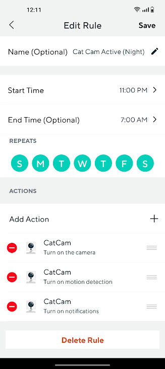

Ok, so I have a v2 and v3 camera set up and the v3 is fine, but v2 will not always work with the schedule I have set up in the app. The shortcuts/triggers I setup with custom actions work fine, but schedules will often be completely or partially ignored. I say partially because sometimes the camera will turn on, but motion detection and/or notifications won’t turn on. Or when the “On” schedule ends, it won’t turn off the camera but does turn off detection and notifications, but sometimes all of the schedule items work correctly both when it activates and deactivates, but this is rare.
Can you post screenshots of all your applicable rules pages, and make sure all actions included in the rule are included in the screenshot. If possible can you also upload screenshots of your rule history page covering the times that you’re having issues, and make sure to open up the drop-down on the rules on the history page by clicking the little icon on the far right to expand that line.

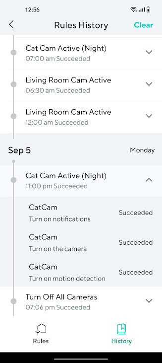

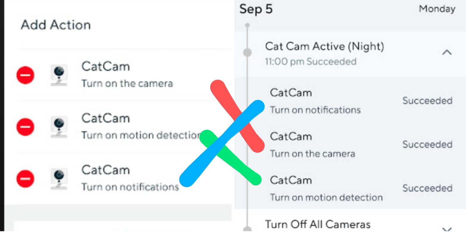

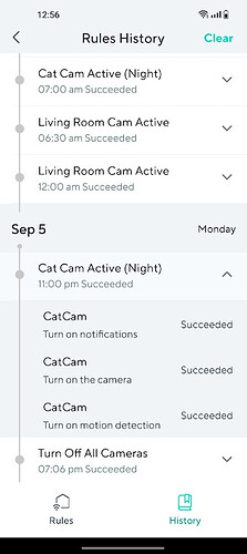

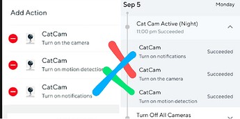

Here’s some history for one of the nights the v2 cam didn’t work, yet all of the items show “succeeded”. I am also on the latest build, according to the Play Store; v2.34.0 (75).
Got it. Could you please submit a log for this? And the rules you are missing here is sep 5? Any recent time (in the past 24 hours) that the camera fails to trigger since logs for Sep 5 might already been overwritten. Thanks!

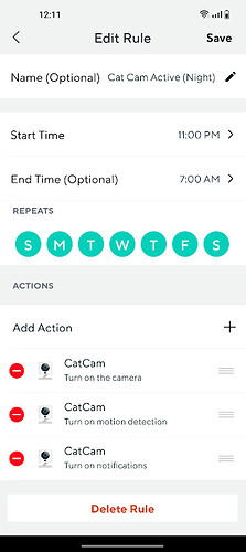

My first recommendation is to remove the actions “Turn on motion detection” and “turn on notifications” from this rule and only use “turn on camera”.
Now go into the camera device settings and enable motion detection and enable notifications. I recommend this because when the camera is off. It doesn’t detect motion or send notifications anyway so using only the one rule action to turn on the camera is all you should need. Are there any actions that are below the ones above, that you’d need to scroll down to see?
The rule logic is that at the start time, all the included rule actions will be blasted at the camera and things may not be received in the order that they should be or missed because they are all being received at one time. Your rule history even shows this may be happening. Compare your action list with your rule history list.
The above may be what is causing you to experience this:

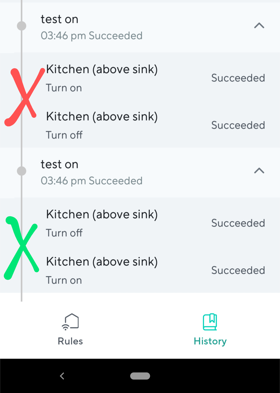

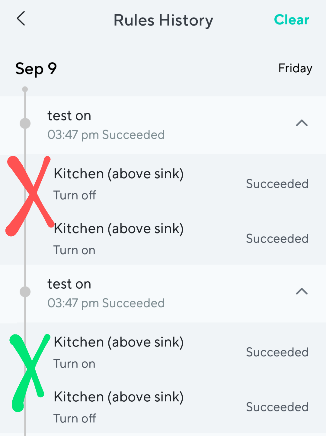

I just created a shortcut to visually test the rule order and commands received issues.
I first created a shortcut named “test on” with “turn on” and “turn off” one of my bulbs. See below:
With the bulb off, I waited a bit after I created the shortcut then pressed the shortcut. In all, I pressed the shortcut four times, and the bulb only turned on twice, and remained off the other two times. Each time the bulb turned on, I would click the button next to the device on my home screen to turn it off.
According to my rules history, this is what history showed with some marks to show which shortcuts actually turned on the bulb or not.
Screenshot_20220909-154934~2
Note the orders of the actions changed when shown in the rules history compared to the shortcut rule itself, and when the bulb did turn on it was not necessarily when the turn on action was listed first. Also note that each of the actions stated “successful” but there were time that the bulb did not turn on.

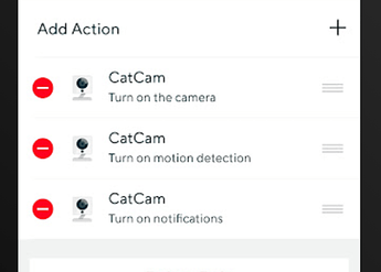

As you can see in my screenshot above for the rule, it’s only “on” for each item. I also do not have additional schedules set up to conflict with the one I shared an image of.
