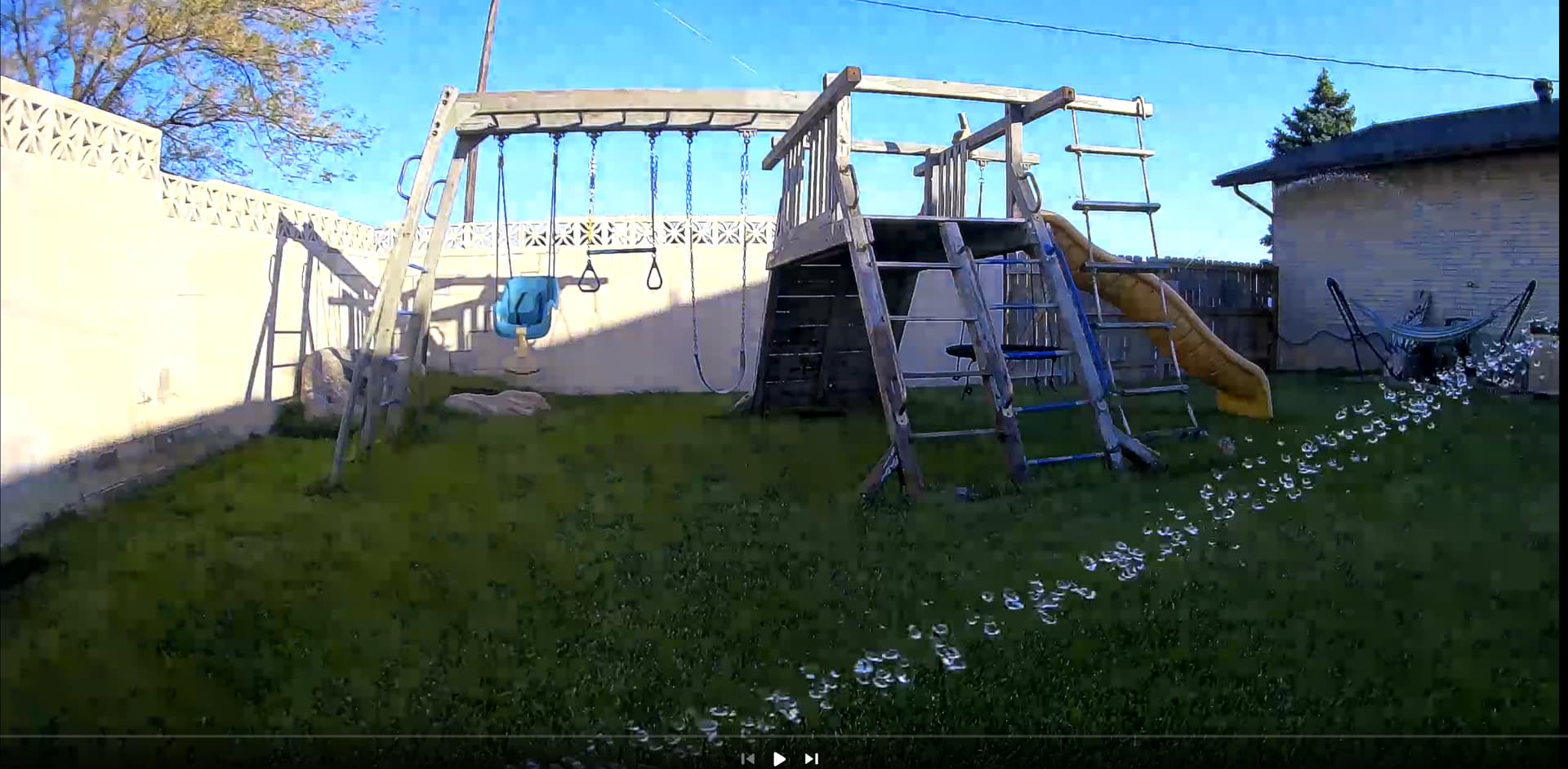

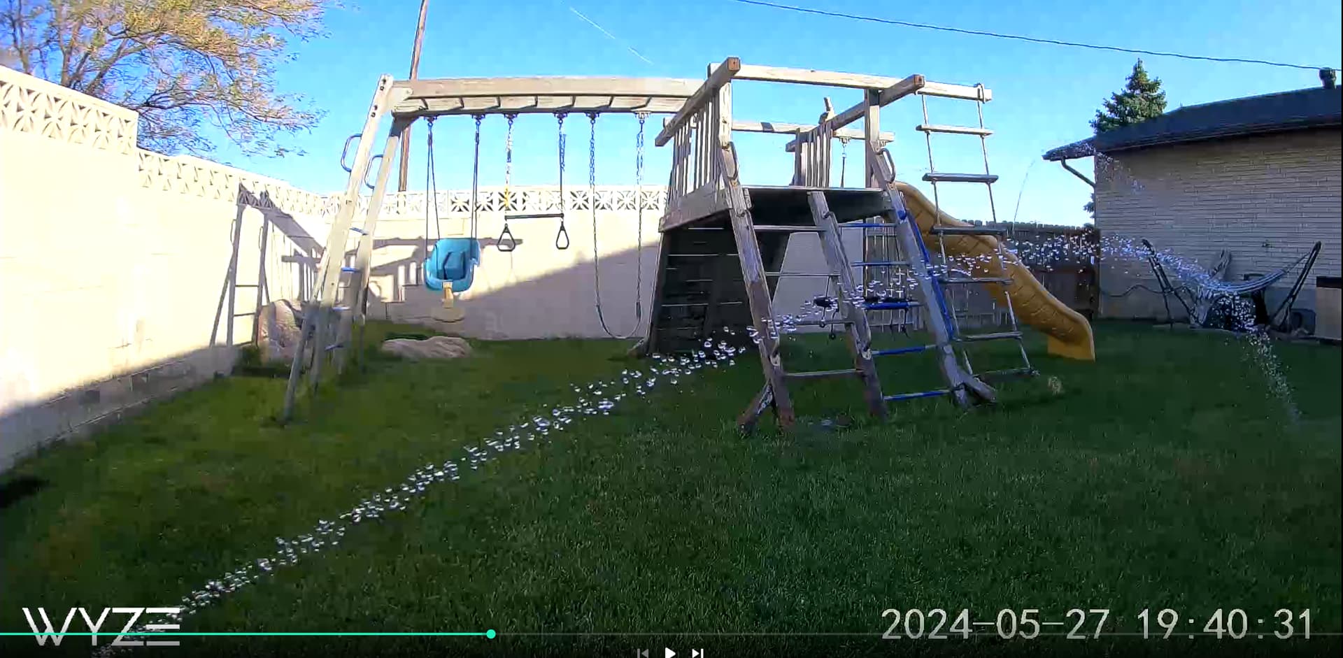

  • The most relevant search results for “beautiful” and “Pretty” was this cool event of my smart sprinkler spraying water past a battery cam pro and capturing little water drops spraying across the screen:
    And one of the most relevant events had my wife and kids in it with the kids playing on that old playground.

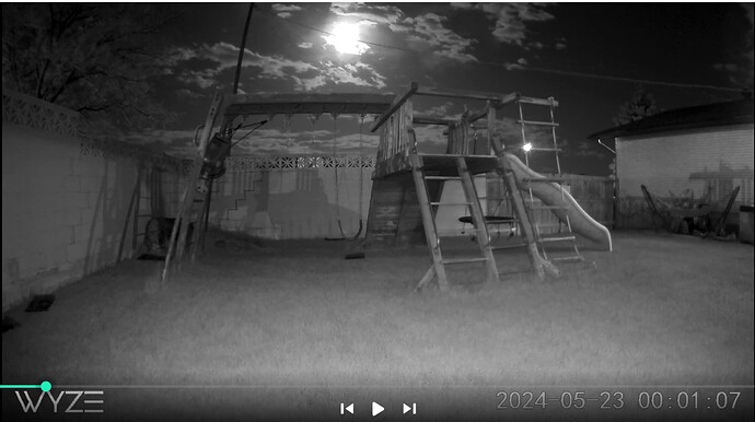

  • “Sunrise” got tricked by showing the bright FLPro light reflecting off my pool water like you often see with the sun on a lake, but this is 10pm at night:
    (though to be fair, that was the 10th most relevant result…the other results were all sunsets)
