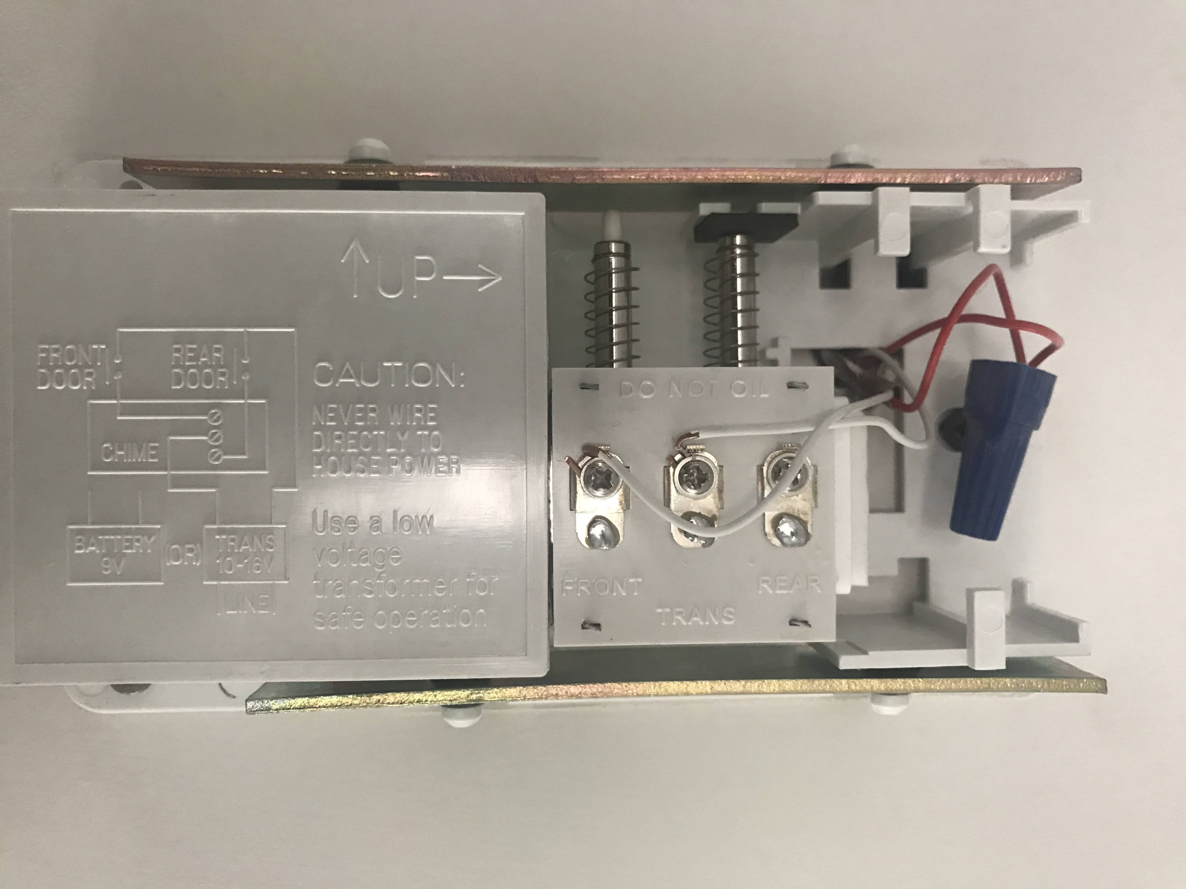

This is my DoorBell House Chime. I have 2 White Wire’s and 2 Red Wire’s coming into the chimebox, 1 White box cable is going to FRONT and TRANS, and the Red Cable’s is a closed circuit.
Is it possible for me to use house-chime because of my setup?
no, you would need to connect the 2 whites wires
What’s the Red Wire’s for? And do I have to use the ByPass Cable that comes with the Wyze Doorbell to bypass my Mechanical Chime? Or can I leave my setup as is, install my wyze doorbell at the front and see if it works?
Interesting… On my current Skybell door bell I didnt have to mess with the house chime at all. I just hooked the 2 wires from the original doorbell to my new video doorbell and that was it. In the Skybell app I’m able to choose whether to ring the house chime or not. Would have been nice if this one was set up the same way. But I guess its not much different since it comes with an external chime. Only real difference is the extra step during installation.
it depends on how yours is wired. mine has 1 wire from the doorbell to the transformer, and another wire from chime to transformer, so in my case, I just connected the 2 wires at the chime, which essentially makes a direct connection from the doorbell to the transformer. yours may be wired with the doorbell with 1 wire from chime to doorbell & 1 wire from chime to transformer. either way you would have to bypass the chime
My transformer is wired just like your chime, it’s essentially the same
So the 2 extra red wire’s I have is to be ignored?
How come Wyze does not supply a Power Kit to use to attach between the FRONT and TRANS which should give it enough power to do chime and doorbell?
And if I just plug in wyze doorbell at the front, and leave my chime box as is, would it just not work? Those red wire’es must be for something
when u push a standard doorbell, it’s closing the circuit giving power to the chime, without bypassing the chime, the doorbell won’t boot…it needs that 16v-24v power
