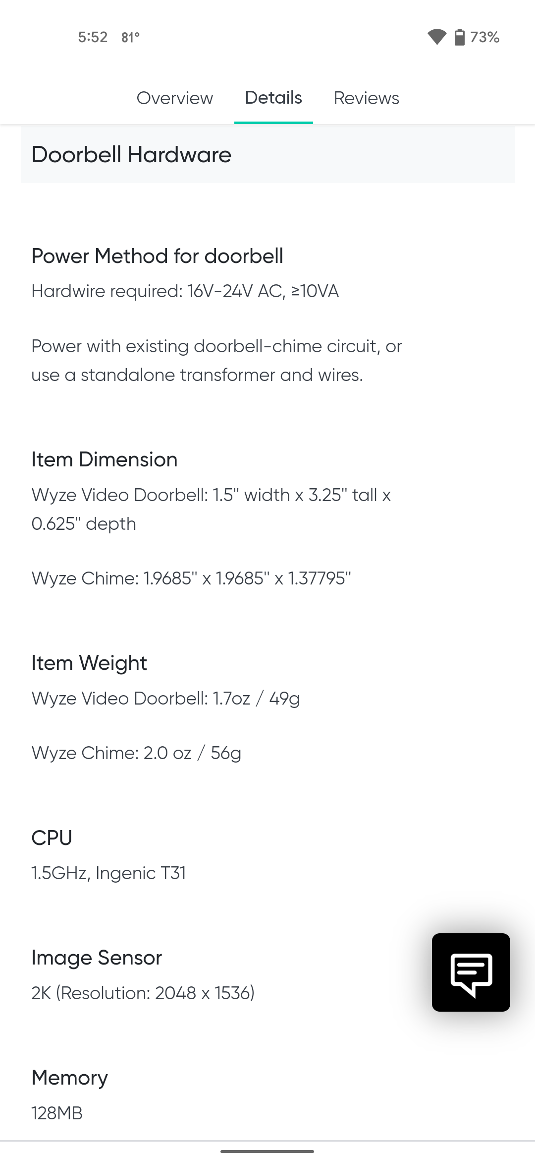

Is there any timeline for the 2K update?
My guess is they will put a starlight sensor in it first, but I don’t think that has started either due to the chip shortages.
The current doorbell sensor does support 2k we had it for a time during beta testing. I thought they said it would be added, I’m surprised it has taken this long.
I don’t know about the doorbell, but I saw something like ‘max’ on the V3, but it was no different than 1080, so they dropped it. I’ve never seen a 2560x1440 resolution on any Wyze device, personally.
Interesting. So they show it as 2k now, but when I save a picture or clip it is 1296 × 1728 pixels. Not quite 2k, even the 2048 version of 2k. But more than 1080. So my thought is they already think a 2k sensor is in there, but why no actual 2k resolution?
The software doesn’t support 2k yet. Hopefully they will add support eventually
