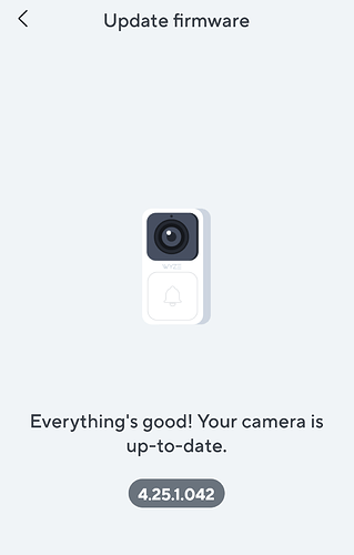

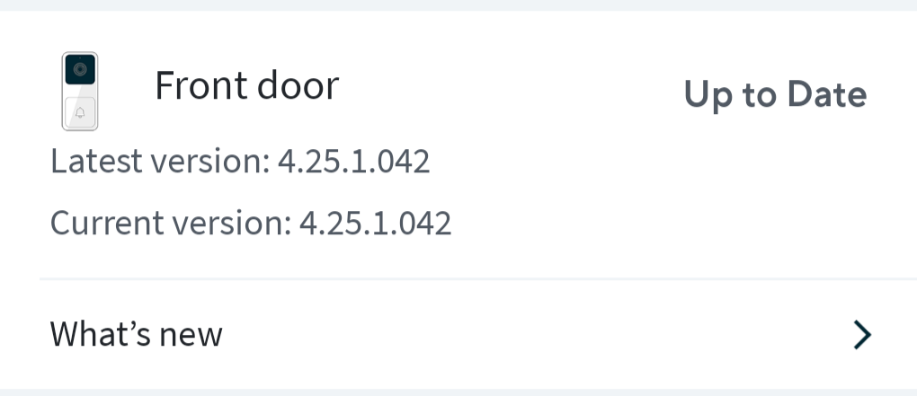

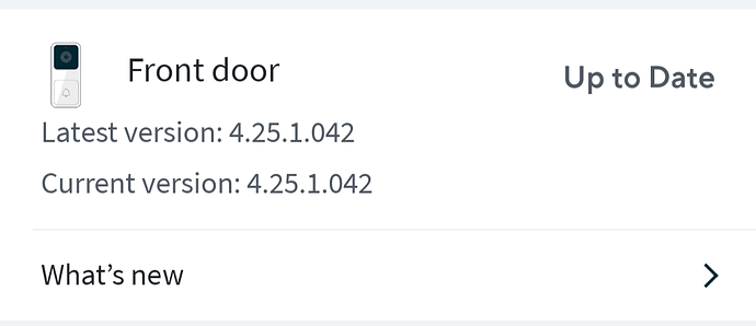

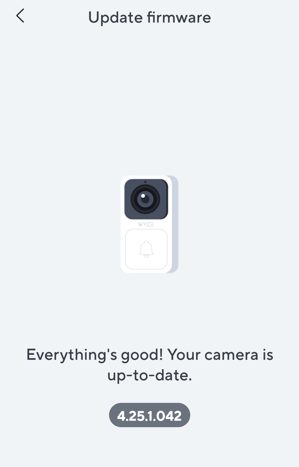

This is what I see in both Firmware Update and in the Doorbell Firmware option
