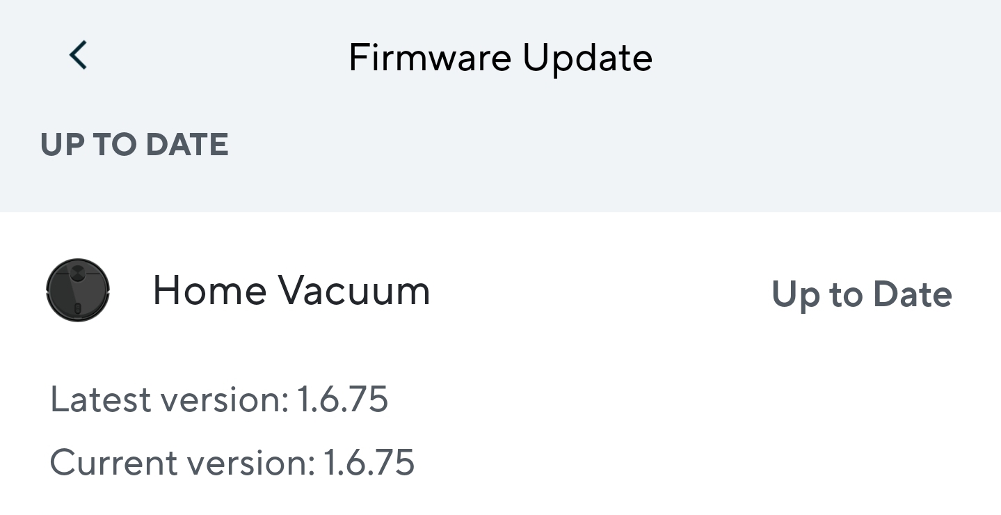

I am on Android, Samsung Note10+ running the WYZE beta app and look as if the firmware is the same for the vacuum
Same here. Since its new, bug reporting will be very helpful. And then maybe we’ll get a beta to test.
