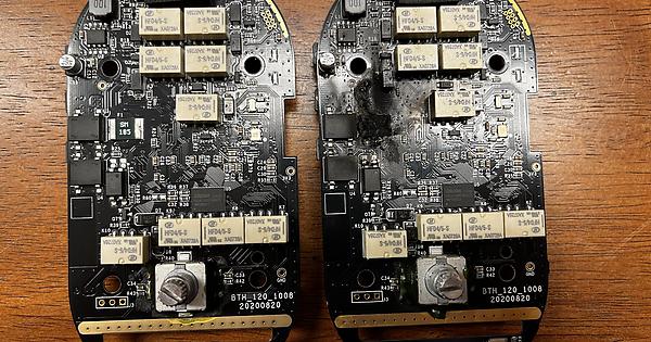

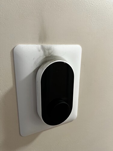

Hello! Ordered and installed 2 Wyze thermostats December 2020. My house has separate units for upstairs and downstairs and neither have C wires so I used the included C wire adapter.
A few weeks ago I came home to both thermostats dead. Then, the one on my downstairs unit appears to have overloaded and shorted itself out, as you can see in the above pic.
I was out of town so perhaps there was an electrical surge or something while I was away. The transformer for the downstairs unit was also blown.
After tearing the things down, it looks like the blown component was a fuse on the back side. The upstairs unit looks unharmed, but still does not work.
Did I wire these things up wrong or something? I followed the step by step directions in the app closely and as far as I know I did everything correctly. Both thermostats were installed identically.

Hi
It looks like a surge went beyond what the fuse can take. We upgraded our fuse tolerance level in the 2nd batch of production. Please contact our support team for a replacement.

I just had this same issue with both of my wyze thermostats . I have 2 that i preordered as an early adopter that just kicked the bucket today. After a significant amount of trouble shooting i submitted a ticket (1658126). Afterwards i opened one and found yhat the fuse was blown.
I submitted a second ticket and included the following images. The second ticket was 1658143.
